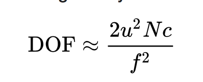

1 diopter = 1000mm focal length
Adding the 8+ to your lens makes it 77mm.
Assuming 1/p + 1/q = 1/f
Where:
p = lens to subject in mm
q = lens to film in mm
f = 200mm
You can estimate your 'q' for whatever minimum focal distance you can get with you 200mm lens.
Then put 'q' calculated from above in the equation and solve for 'p' with a focal length of 77mm.
Your result 'p' would be a rough estimate of closest focal distance.
So, if you find your lens and the diopter focus to 1 meter then your DOF at f8 would be around 65mm using the equation below.
Where:
u = subject distance (1000mm)
f= focal length (77mm)
c = your minimum CoC size maybe 0.0025mm
N = f8

Excuse me, when you put a 8d lens in front of the taking lens of any focal, when the taking lens is focused on infinity, your subject must be at 125mm, and if the minimal focus of your taking lens is "say" 1m, your subject must be at 111mm (8d+1d). And in both cases, the depth of field will be very shallow (I did not take the time to check your formula). Anyway, you cannot focus on a subject at 1000mm.

Ok, with 2.5m minimal focusing of the lens, your subject must be between 125mm and 119mm (thus no use focus the lens), focus by moving the camera back and fro.
And at f8 you will get a DOF of 1mm (taking a COC of 0.025mm not of 0.0025mm - which is way too small). Most important : your field of view in a 24x36 image frame will then be 15mmx22mm (a magnification greater than 1 !).

Okay, thanks indeed! I think I skip to purchase the 200mm lens. I had a Raynox before and it’s fun and I used it on a 55mm lens but I wanted to increase the dof by getting a longer lens. As the dof won’t increase a lot I just leave it.

Laci, depth of field is determined by aperture and magnification. Focal length has nothing to do with it.
