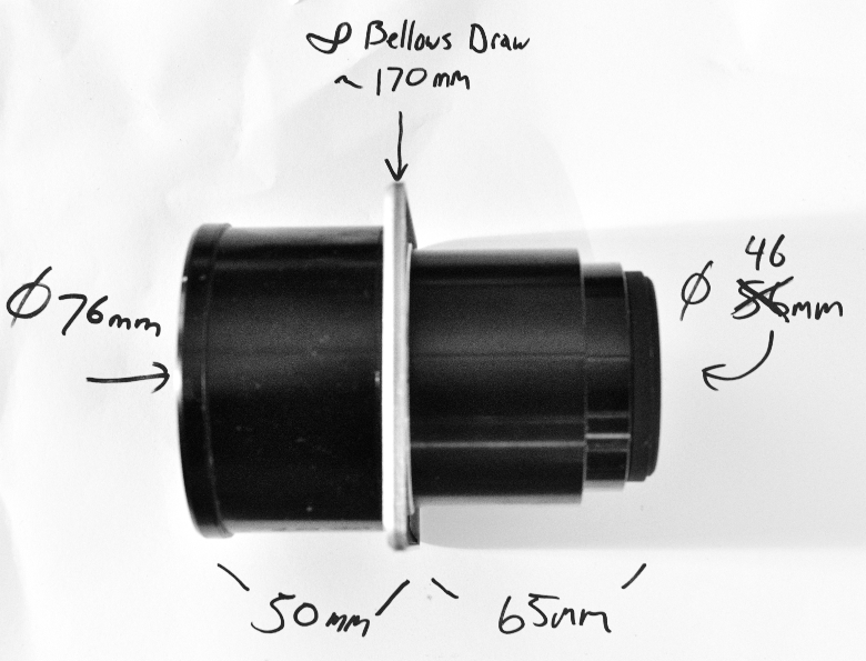

Here's a question that's in the same ballpark: what is the effective f-stop of the lens below when used at infinity?
Pentax 67 SMC 300mm front group used as a barrel lens in a speed graphic board. The complete lens had an aperture stop behind what is now the rear element and an additional negative element behind that.
Is it as simple as (170mm / 76mm) = 2.2? Or does the odd rear node and protrusion of the lens into the camera necessitate some additional considerations? Being a telephoto design, my naïve intuition is that any additional light afforded to the film plane by the protruding rear section is being 'eaten' by the optics thus rendering the simple calculation valid.
AFAIK for calculating the numerical aperture you work with the diameter of the aperture as projected through the front of the lens. You can take a ruler or caliper, face the lens head-on and guesstimate the aperture diameter that way. This is generally a little less than the diameter of the front lens element/group.
Focus setting/distance doesn't matter; this is only useful to determine focal length by focusing at infinity. Neither does the length of the lens as such matter, etc.
At least, according to my (limited) understanding of the matter.
That sounds about right; since you know what lens you've got, it's a little easier. You know it used to be a 300/4 lens, originally. This means the projected aperture diameter was 300/4 = 75mm - indeed quite close to the 76mm you found, but note it's a smidgeon less. If the front group alone gives a focal length of 170mm, the wide-open numerical aperture will be 170/75 = f/2.27
A sanity check proves this should be about right since you're using the same front element but the focal length is now roughly half that of the original lens, and indeed your new combination is roughly a stop faster.
The f-number is the focal length divided by the apparent diameter of the entrance aperture. Your numbers for the bellows draw and diameter of the front element are probably pretty close for that lens, although there are lens designs where there would be differences. For ex, for most shorter-than-telephoto lenses, the entrance aperture is smaller than the entire front element. For highly asymmetric lenses, sometimes the flange-focal distance is fairly different from the focal length.
You can actually measure these numbers more accurately. For the entrance aperture, just lay a ruler across the front of the lens and measure the apparent diameter of the clear aperture as seen from the front.
For the focal length, you can get pretty close by measuring how far the lens has to extend past infinity to focus on an object of known distance or magnification ratio, and using simple lens equations. This can require a little care (and math) to get an accurate result. For an example, one way to do this is to measure the bellows draw at infinity, and to measure it at 1:1 magnification. The extension past infinity e = f*m, so measuring the extension needed to get to 1:1 gives you the accurate focal length.
The reason that focal length can be different from the bellows draw at infinity, is that the bellows draw is just the mechanical flange to focal distance, while what you want is the distance of the rear principal plane to the film, and the principal plane can be offset from the mechanical center of the lens. This is true for lenses that have a strong meniscus shape, for example.
The mechanical configuration of the lens - how far the elements protrude forward/back, and so on - doesn't affect the f-number.

I wouldn't measure its focal delta at 1:1, a telephoto like this will have very poor correction, try something like 2m object.
This lens will not be very well corrected without the rear element, it must have a fair bit of field curvature and some distortion ?
