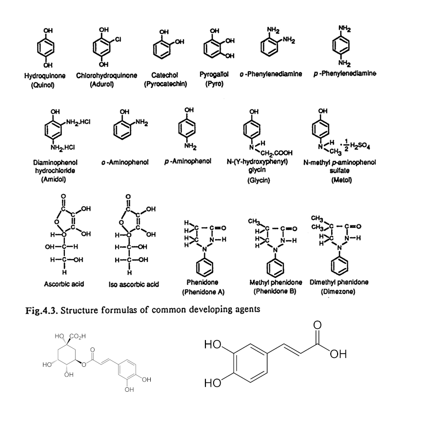

Alan, interesting observation. I didn't know about the size of phenidone. It always seemed to me like a big molecule... bigger than HQ and most benzene ring like molecules.

As a side note, I recently read somewhere (in someone's web, not a book) that ascorbic and phenidone don't follow the Kendall-Pelz rule, but they do.
Ascorbic molecule has OH-(C=C)-OH on the top-right (on my attachment), which clearly places it in HQ group.
Phenidone can be converted to OH-(C=N)-NRR, if I'm not mistaken. There was a thread about Kendall-Pelz rule here.
There is a good description of this in Grant Haist's "Modern Photographic Processing", highly recommended reading BTW, and quite a bit easier to read than T. H. James's "Theory of the Photographic Process".
Allow me to provide you here with a very brief summary:
Early in the 20th century researchers tried to establish rules for determining, whether a compound would work as photographic developer. There were the Lumiere- Andresen rules, which covered aromatic rings with two substituents of type -OH and -NH2 in ortho or para position, and possibly some extra substituents, and which also described how substituents would affect developer activity. This Lumiere-Andresen rule covers many developing agents still in use today, but it does e.g. not cover Hydroxylamine or most color developers.
This Lumiere-Andresen rule was then extended by Kendall, who included any carbon chains with alternating single and dual bonds, and which also included a wider range of substituents. This is the Kendall rule, which is frequently written as A-(C=C)n-A' with A from -OH, -NH2, -NHR1 and -NHR1R2.
As you can see, the Kendall rule in its original form would not classify Phenidone (which was found by Kendall anyway, that's why this whole issue is even mentioned so often) as a developer. The Kendall rule was therefore extended to include A-(C=C)n-A' and A-(C=N)n-A', and this extended form is called Kendall-Pelz rule. And yes, the Kendall-Pelz rule correctly classifies Phenidone as photographic developer.

Rudeofus, thanks for your summary.
Since you mentioned it, I never really knew if it is n=2 or n=3 for HQ (I've read both, and both seem reasonable as "number of double bounds between functional groups") and also if meta substitutions satisfy the Kendall-Pelz rule. We know they are not developers, but aren't they just n=1 developers according to the rule ?
I stumbled over this same question a while back, and proper chemists told me the following:
A-(C=C)n-A' means A-A' for n=0, A-C=C-A' for n=1, A-C=C-C=C-A' for n=2, A-C=C-C=C-C=C-A' for n=3, ... Therefore Catechol would follow the Kendall(-Pelz) rule with n=1 or n=3 (depending on where you draw the double bonds on the benzene ring), and HQ would correspond to n=2. Resorcinol would not follow this structure for any n and is also not known to work as developer.
