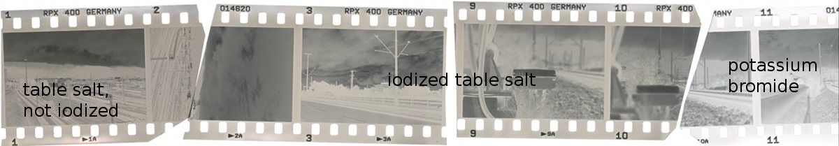

I also like Caffenol CL for its results, but there's times I just don't wanna wait for an hour! Also, can vouch for the 'iodized salt for KBr' swap mentioned above, though I used 5x instead of 10x as much salt as Kbr. Maybe I'll try 10x now!
Here you can see the efficacy of Kbr vs iodize salt. Photo from caffenol.blogspot.com.
In my experience, I've found it to be quite important to ensure anhydrous soda. I weigh out an amount that I'll use over time, heat it under low heat in the oven until the weight doesn't change, then store in a tightly sealed glass jar. I'm sure the soda picks up some moisture every time I open the jar, but I must use it all before it becomes an issue.
You can also multiply by 1.2 to 2.7 the amount when it is wet soda. But for better price the anhydrous is less expensive. I don't think moisture can proliferate in soda :smile: It's more humidity.
