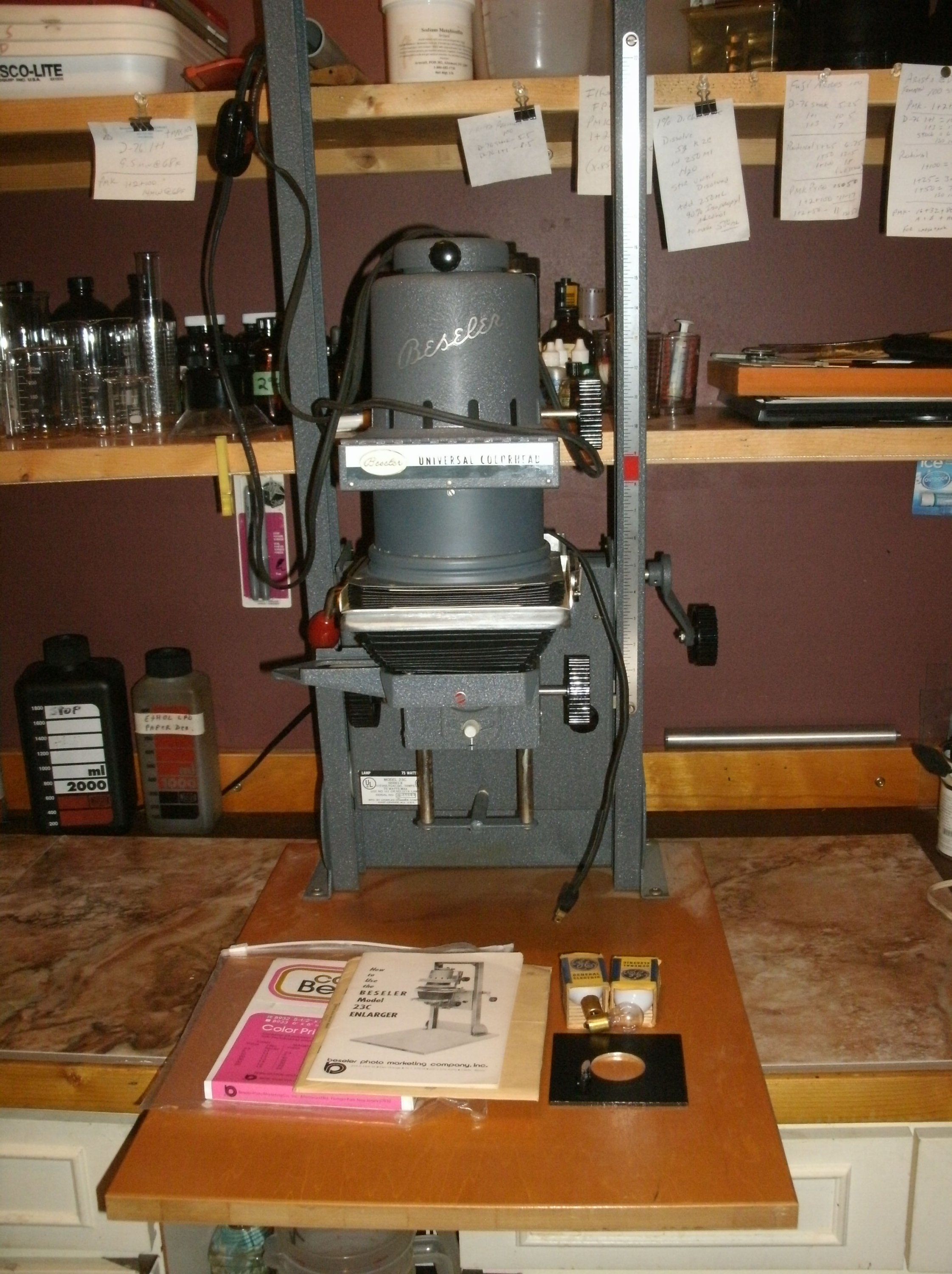

OP, if you want to do a road trip to southwest Pa. I have an older Beseler 23C that actually is in excellent condition for cheap. I'm sure if I dig through my boxed up darkroom I could even come up with a 50mm lens and a timer.
