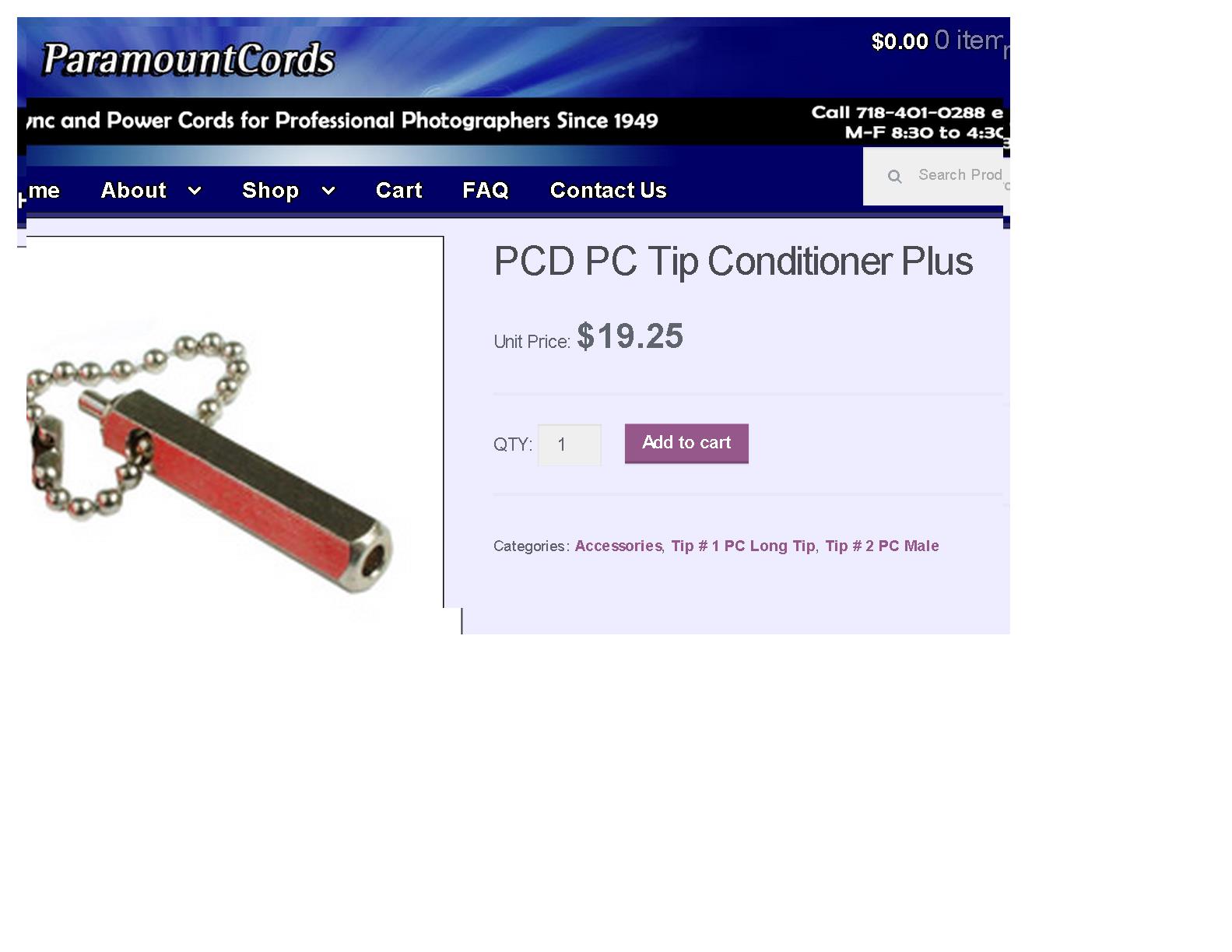

When you get deeper into this, you'll find you carry a bunch of extensions and peanuts though!
And the handiest accessory of them all:
attachment.php
