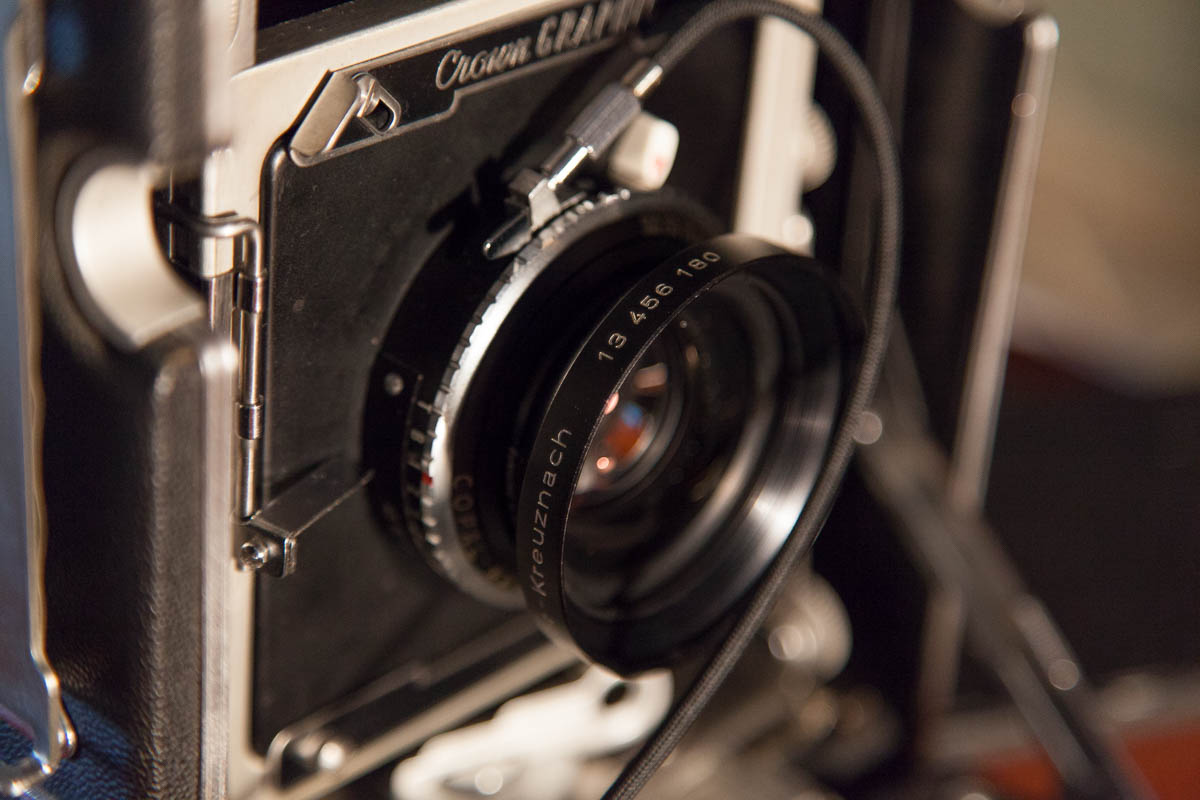

· Crown Graphic
· Symmar-S 150mm f/5.6

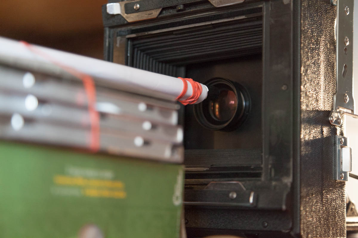

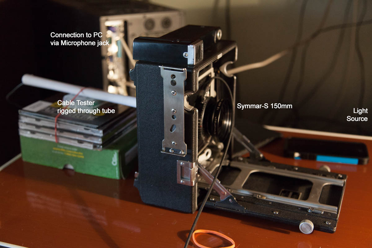

1. I started off with making sure I had a proper rig according to the manual of the shutter tester. Here's what my setup looked like:
attachment.php
attachment.php
attachment.php
2. I made sure to have a constant light source at an adequate space away to avoid any possible error, according to the manual
3. With tester lined up behind the rear element, light towards the front element I can now start testing

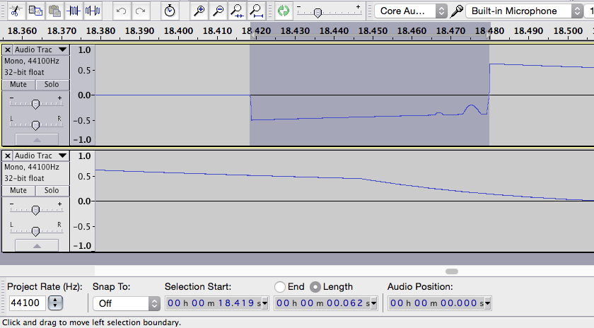

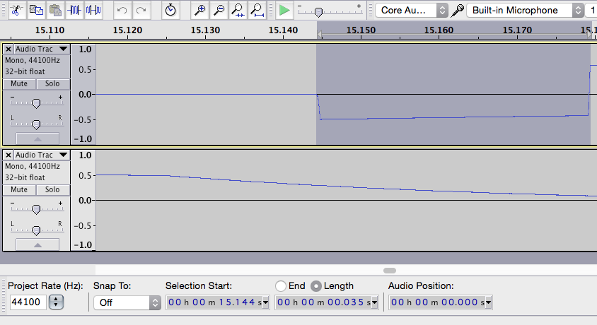

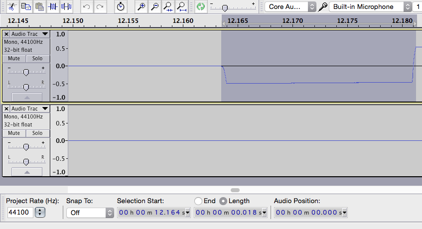

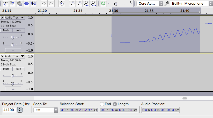

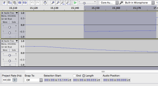

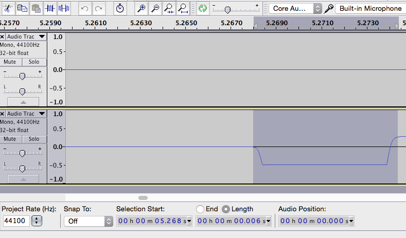

Below I’ve also included screenshots of each of my highlighted work areas of the specific shutters. The only thing I’m concerned with what I’ve done is that my working test results don’t match the shutter “good” shutter spikes included within the manual. I’m not sure why, but from what I’ve understood these can be considered equal, I have no way to completely verify the results other than the help from the community to improve my tests.

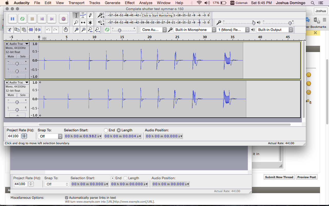

Total Tests:
attachment.php

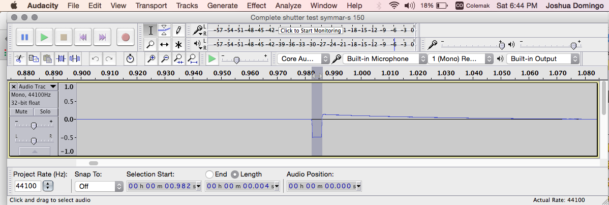

Test area for 1/500: 0.004
attachment.php
​Test area for 1/250: 0.006

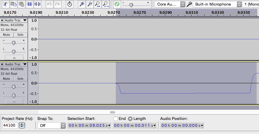

​Test area for 1/125: 0.011

​Test area for 1/60: 0.018
attachment.php
​Test area for 1/30: 0.035
attachment.php
​Test area for 1/15: 0.062
attachment.php
​Test area for 1/8: 0.125
attachment.php

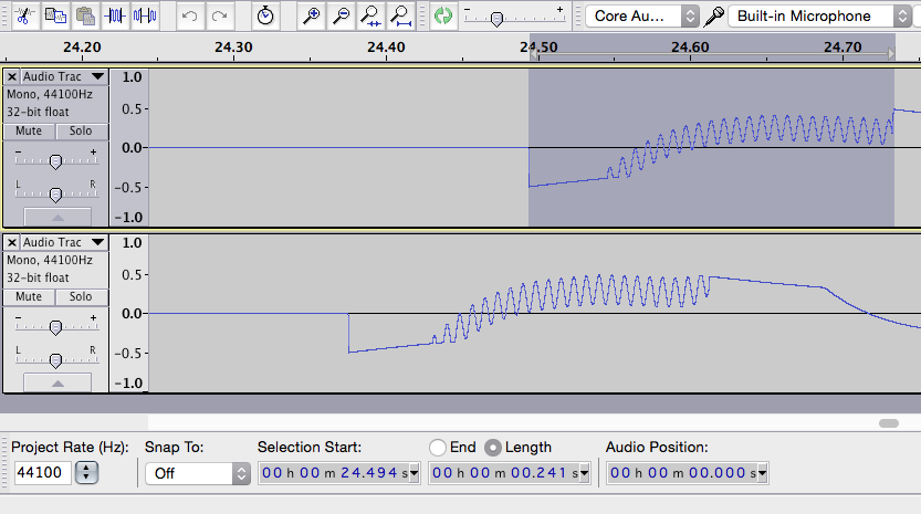

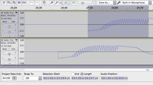

​Test area for 1/4: 0.241

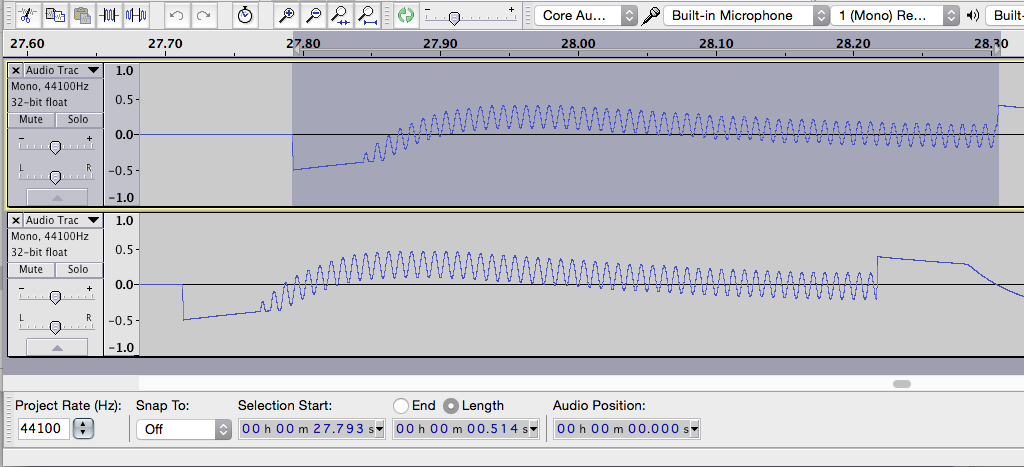

​Test area for 1/2: 0.514

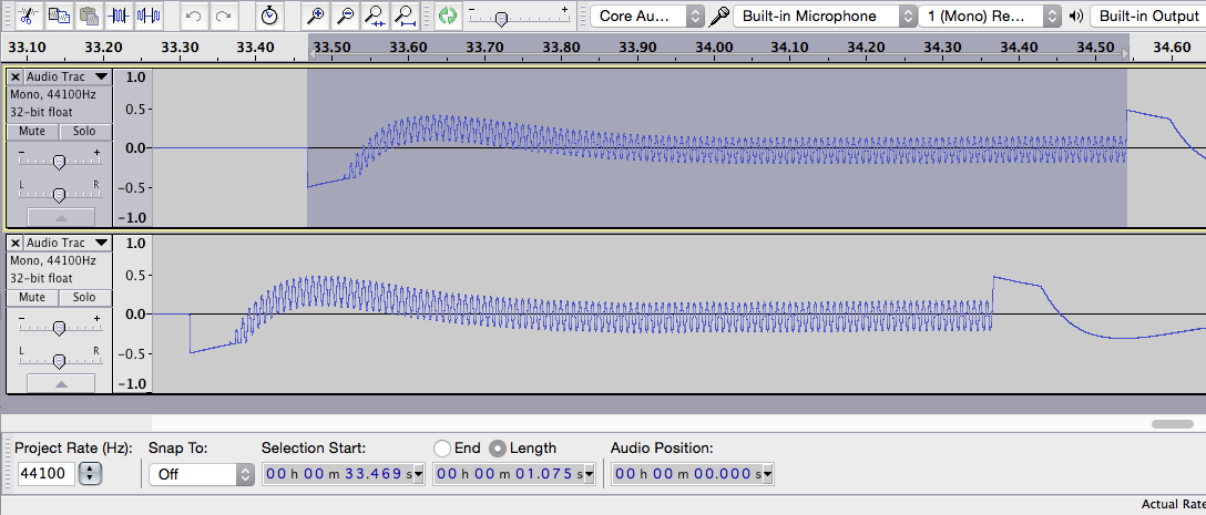

​Test area for 1": 1.075

It appears to me from the waveforms that severe clipping is occurring. This would tend to indicate longer shutter speeds than the actual effective speed. This is further aggravated by measuring just the center of the light cone transmitted through the rear of the lens instead of the entire area of the lens. Testing of between-the-lens shutter speeds with a photo diode is best done with a set-up that accurately shows the intensity of the light through the shutter as well as the duration of the exposure. Then we see that, at the highest speeds, the opening and closing of the shutter can take a significant fraction of the total exposure time. With the lens wide open, exposure on film begins just after the shutter blades begin to open, and continues until they are closed. When the lens is well stopped down, no light reaches the film until the blades have moved a significant amount, and the light is cut off while the blades are still moving. A shutter tester that merely indicates when the blades start to move and when they are closed will indicate a slower shutter speed than the film sees. especially at the highest shutter speeds.
Using a pulsed light source (or a gated photo diode) as mmerig describes is one way of getting numerical values for shutter speeds. However, using an oscilloscope to plot the light intensity through the full diameter of the lens against time is more useful. It does require interpretation, while a simple sound measurement can give a less accurate digital result. An oscilloscope can also measure flash delay and shutter bounce.

Results:
At first I was quite scared I had done the test wrong because my 1/250, 1/125, and 1/90 speeds were a bit off, thinking I did it wrong I tested multiple times and with almost identical test results, I came to the conclusion these speeds have gotten slower.

I don't think your shutter has gotten slow. These results are approximately what I'm getting for my leaf shutters, too. I assume you are measuring the time from when the shutter starts to open to when it is fully closed? That's different from the effective shutter speed. At those faster shutter settings, the time it takes to open and close the shutter leaves becomes a major factor. When you set the shutter to 1/500 and measure 4ms, then for most (or pretty much all) of those 4ms, the shutter isn't actually fully open but on its way to open or close. So effectively the light that makes it through corresponds to a 2ms exposure.
What you want to measure is the time from when the shutter is half-way open to when it is half-way closed (with aperture set to max opening).
