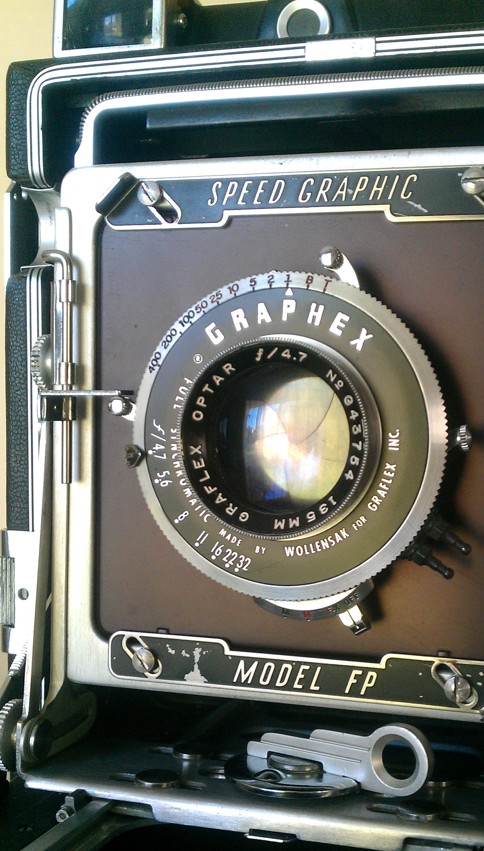

It may be that the shutter has a "press focus" lever, as shown at the 3:00 position on mine below. Mine also has the T setting. My lens and shutter are typical for Speeds. Either allows you to open the shutter completely for focusing on the groundglass.

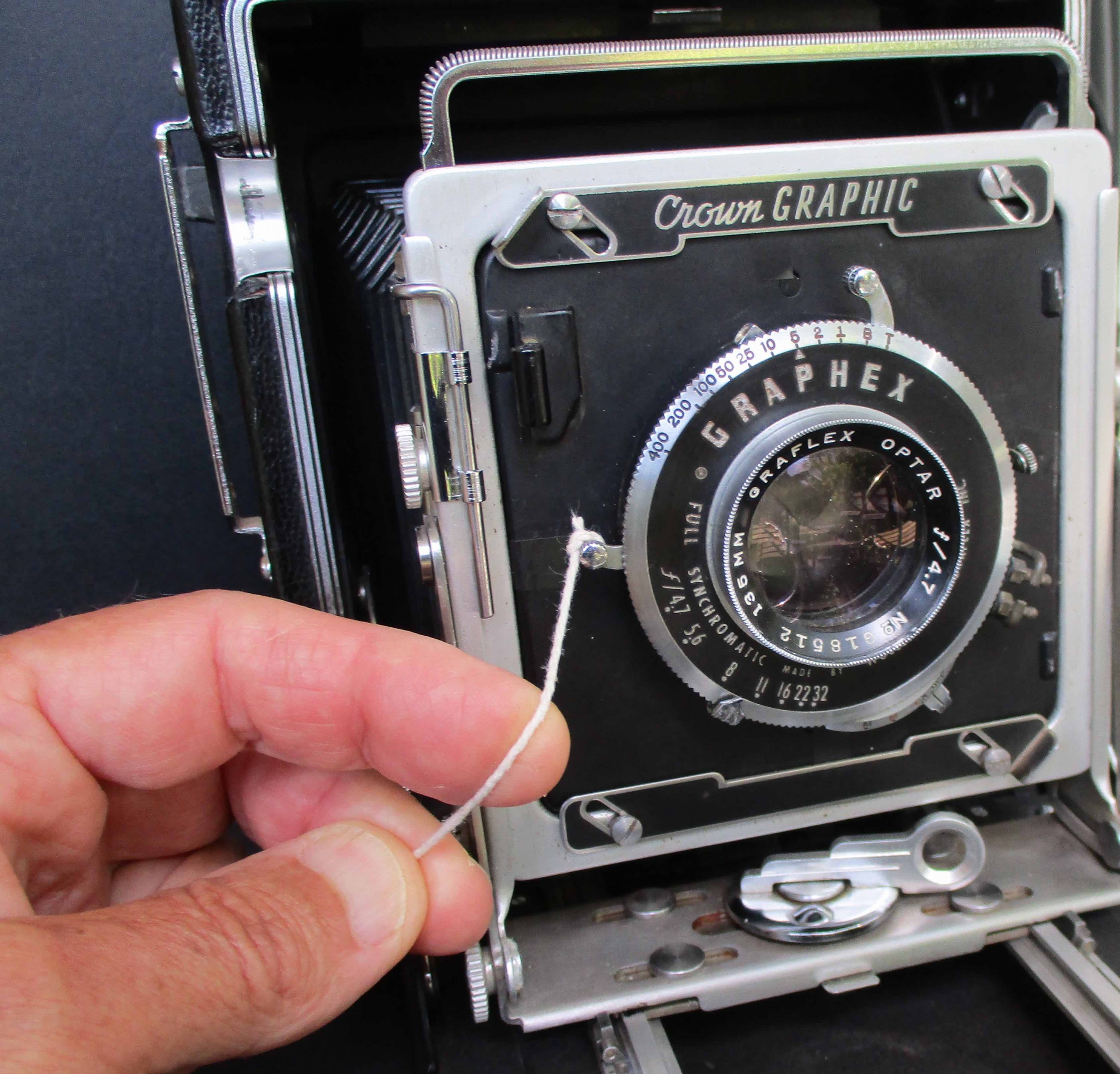

My problem with a well used Crown Graphic was I could not use a cable release at all! The thread on the Graflex shutter was worn out and the body mounted shutter release was not smooth enough to prevent camera shake on long exposures. A simple hack that works perfectly well is to attach a string to the shutter release lever - my apologies to purists!

Interesting! Original poster here, my CG cable release threaded part did not look very healthy, visually, but it took in a couple of very used cables.

Jay, I did consider using JBWeld to add a short extension to the shutter thread but realised if I got it wrong it would be a disaster! I also thought of screwing a cable release terminal to the lensboard above the shutter release lever but I felt this was getting overly complicated. Very little tension is required to trigger the release so a string achieves this easily without camera shake. Three advantages of this hack are that it is simple, the string can be left attached while the camera is folded and, if a more sophisticated repair is contemplated in the future, the camera is still completely in its original state.
Insert some elastic cord or spring of apt stiffness into to that string and you even would not induce shake the moment the lever arrives at the end of its travel. (In case that still would fall into exposure time.)

I'm surprised my "string solution" elicited so many responses. The helicoil could work but I'm not sure where one with the appropriate threads could be sourced.
Regarding an elastic "string" - in my view this would not be a good idea - if one uses a release which is "solid", either a conventional cable or string, it is easy to gently trigger the shutter release lever without it ever reaching the end of its travel - about 1/2 way down on all of my lenses. An elastic system could not give this degree of control and the lever would somewhat uncontrollably reach the end of its travel, potentially causing camera shake.
Of course, if one could seek a replacement lens but why retire the original lens which has superb optics and accurate rangefinding, when 6 inches of string does the job?

Shutterfinger - originally I did try to find someone to do this simple repair, but in New Zealand such skills are now as rare as hens teeth! In the meantime, I have been super impressed with the "string solution" and find the control it gives over gentle release with long exposures is at least equal to that of a conventional cable release on both my Crown Graphic and Rolleicord. And just to prove there is nothing new under the sun, I gather a hooked wire fitted into a slotted release lever was quite common for pre 1945 shutters - although obviously not as convenient as a cable release for most photography.
