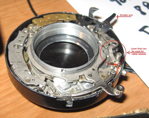

I got a deal with a broken 6x9 Russian folder. Body and bellows were useless. I scraped them. I used the lens and shutter for some project cameras. It worked well a bit, but I found that I needed a cable release for the longer exposures. I did not want to mess with a good thing so I just used the lens and shutter as is. One day I dropped the lens, things got screwy with the shutter for the B and 1 sec setting. Decided to open the shutter up. Be aware of the set tabs that hold the mounting face of the speed set ring. More on that later...
The Bulb setting problem was an easy fix, a matter of putting things in the right place. But I noticed a lever, it is circled red in the first picture. If I cock the shutter, pushing the lever acted the same way as the shutter release arm.

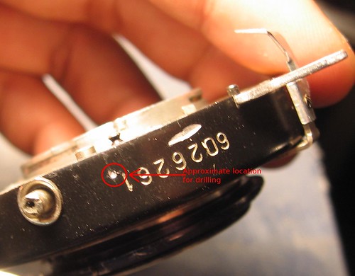

Hmmm, a drilled hole on the side of the shutter would allow a cable release to trigger the shutter.

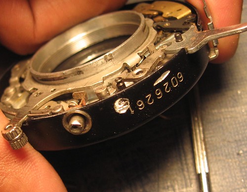

Eye-balled the best place for the hole and started drilling. A tap allows for the screw head of the cable release to screw in a little bit while the cable release plunger activated the shutter.
Once the cable release could be screwed in I needed to re-assemble the shutter cover. The set tabs for the mounting face broke while I tried to reassemble it, so I had to use epoxy to ensure that the set tabs hold the mounting face. Beware that the epoxy does not glue the shutter speed ring to one position. Once you have reassembled the shutter, you have a (hopefully) working shutter with a cable release location. I am still trying to find a better solution to the screw mount for the cable release, but for now it works well for my purposes ... a cable release mount from a Polaroid I disassembled was a good candidate. I just can not seem to find it now :sad:
