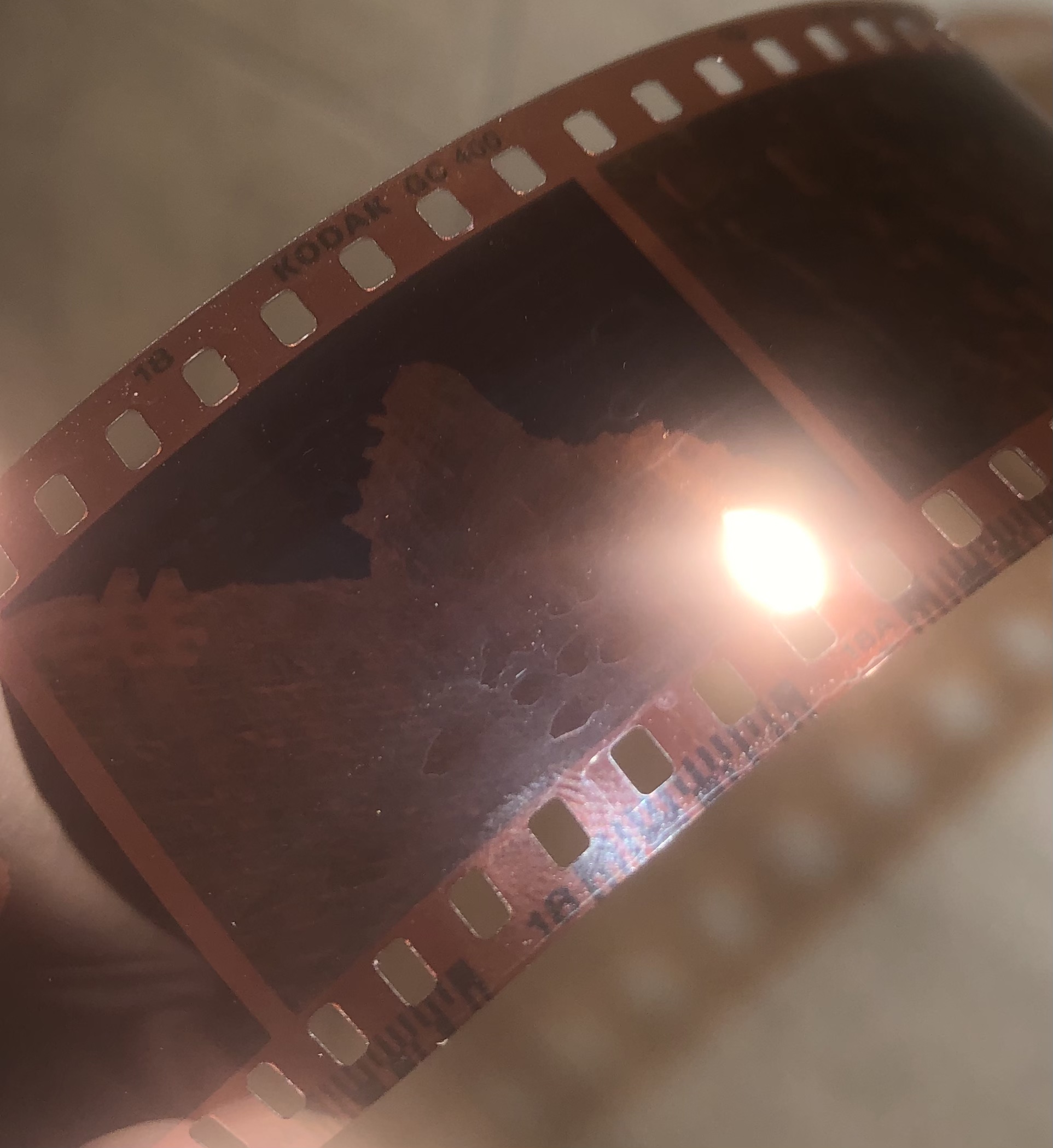

I posted this on Reddit but with little luck, hopefully there’s more insight on here.
C41 streaking problem - help
I’ve developed 10ish rolls of C41 since I started learning in October, on most rolls I’ve gotten these strange streaks. Here’s my most recent example...
mq2Xorr
It’s quite bad as you can see.
But I do everything by the book! The book being this Kodak Publication (https://125px.com/docs/techpubs/kodak/cis211-Flexicolor_in_small_tank.pdf) on doing C-41 at home with a small tank. Albeit, I use Tetenal chemistry, but I use this method since Tetenal outlines no instructions for small tanks.
In this case, all chemicals were mixed yesterday with deionised water and sat in a Sous Vide controlled water bath until chemicals were heated to 38°.
5 min presoak (38°)
3:15 min development, 30 sec initial agitation, followed by 2 sec of agitation every 15 secs.
6:30 min Bliz. 30 sec initial agitation, followed by 5 sec of agitation every 15 secs. I diverted from Tetenal’s instructions here, only because I thought these streaks were maybe due to under-fixing.
3-4ish rinse. I take the light tight lid part of the Paterson tank to do this part, washing the film directly since at first I thought the wash stage was the problem. I previously just kept that part on and let the water get in that way. I also dunk the reel into a Water/Photo-Flo solution for a minute, lightly agitating.
1 min Stab. I agitate for 30 secs then let it sit.
I then leave to dry, hanging vertically, squeegeeing them with wet fingers a couple of times.
I would really appreciate any insight into this problem, and - if possible- any remedies for this roll? This streaking problem has been driving me nuts for months! Admittedly, it’s also put me off doing C-41 at home all together. But I’m sure many of you don’t get this problem so there must be a way!!

Ops, I don’t think the image uploaded properly. I’ll try again.

I use the stabiliser that comes with my Tetenal kit, and diluted according to the instructions supplied. Again, mixed the day prior and used on
once before my example.
And yes, Glasgow water is still soft. Best in the world, apparently! Which is why I’m reluctant to believe it’s simply a drying mark issue.
On top of that, I mixed the chemistry with “de-ionised water”, which is the closed equivalent to “de-mineralised water” I’ve heard people recommend online, but I’m not sure the differences - if any. So even if my local water is the problem, which I’m sure it isn’t since places with worse water quality get clean results, the only time my tap is used is in the rinsing stage.
But with this example, I added just a little bit of photo-flo at the end of the wash stage, agitate, let it set, then pour out and move onto the stabiliser stage.
It really is a massive headache, and I thank you for trying to get to the bottom of it with me.
I think this may be your problem.
Don't use a wetting agent (photoflo) with C41.
I would suggest you do not use the stabiliser at all (films after 2000 don't need it). Instead use Kodak final rinse or buy the Fuji equivalent like these.

Thanks for the suggestion! I’ll try that next time I develop and report back. Shouldn’t be too long.
MacLureo
Dec 12, 2020
9
Glasgow
Thanks for the recommendation! I actually did buy some Kodak Final Rinse yesterday, saw it was £2ish from some shop in the UK in small 50ml bottles. They must rebottle it into more manageable quantities.
Looking forward to see if it helps, I’ve heard similar reports after digging through Reddit. But why would Tetenal’s equivalent product be so much inferior? That’s what I don’t get

  • IIRC there have been reports in the past of Tetenal final rinse leaving marks even when mixed and applied according to prescription
  • going by the pics, this milky/cloudy stuff sure looks like some residue from the final bath
  • final rinse contains a surfactant, using photoflo or similar before or after final rinse is detrimental
  • you should skip the final rinse (or replace it with photoflo) only if long term stability of your film is not a concern
  • I currently use Fuji's final rinse (included C41 X-Press kit) and have had zero problems with drying marks or stains
