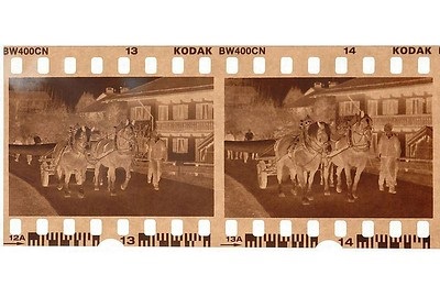

Can you post a shot of the strip of your negs please.
Something like this.
I wonder about your home made agitator. I think it may be too much agitation for tank developing ( full immersion in developer ) as opposed to rotary tube processing.
