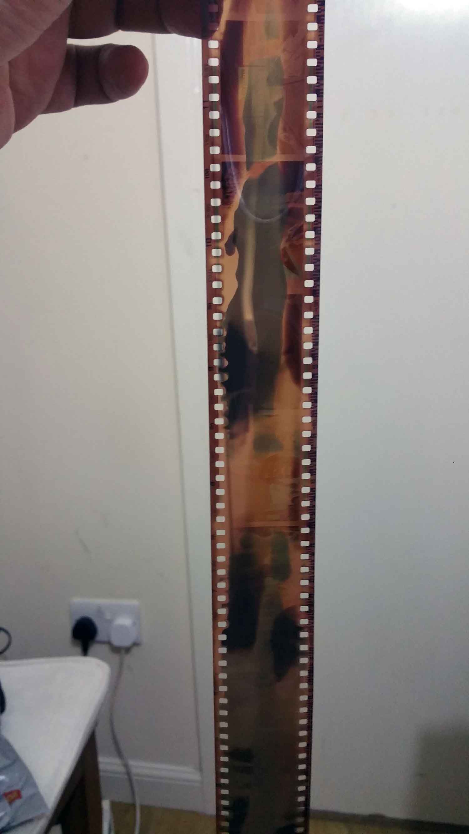

Thanks mate, Another one here, Could someone tell me what has happened here?
Photo Engineer
Apr 19, 2005
29,018
Rochester, NY
It appears that the front of the film made contact with either the processing tank or the back of the film roll and prevented the developer from acting on the film. It may include lack of bleaching, fixing, washing and stabilizing.

Thank you sir, had two rolls in same tank, one is perfect, second was this
mnemosyne
Jan 19, 2011
759
Europe
Looks/sounds like insufficent solution volume in development and bleaching/fixing stage. Have you noticed and observed the minimum volume requirement for the Paterson tank? It should be typically something around 500-600 ml of solution for two 35mm films with inversion.

Many thanks, every day is learning process that i go through things are improving.
