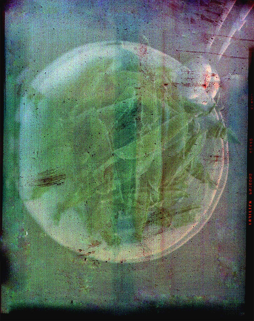

I'm quite new in C41 development. Sometimes I'm getting results like in the attached image. I'm using Tetenal kit. What was wrong? Can anyone give me a hand?

It is sheet film. What temperature did you use?

Looks like incomplete mixing of the chemistry or bad agitation. Not sure. The edge markings seem ok but there is too little shown to really tell.

jnanian would LOVE to get results like that.

Is there any good detail on the negative? Scans of my negs look like this when I strongly underexpose them and my scanner desperately tries to compensate. Processing should be fine, since the film rebate looks good ...

One of my mentors told me that I should make sure to properly mix the chemicals before putting them in with the film.
So I always make sure I shake up my bottles right when I take them out of the temp bath and put them in tank/whatever. This is especially important for the bleach/blix.
I can't give you the scientific stuff. I am horrible at all the technical details.
