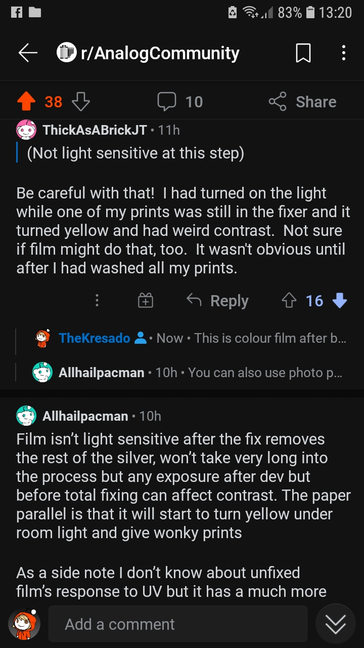

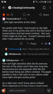

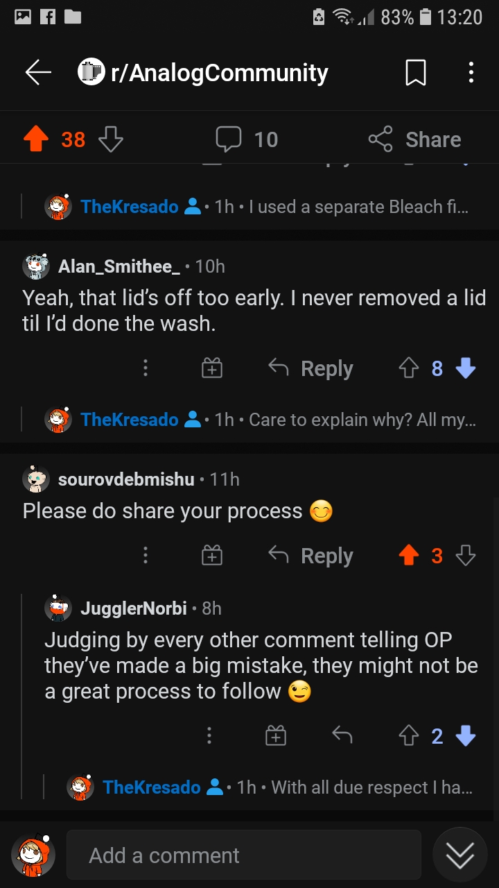

I'm definitely certain I didn't misunderstad what people were commenting.
Ignore my downvoting spree but I really think most people on Reddit have no idea what they are talking about.
