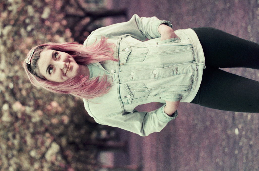

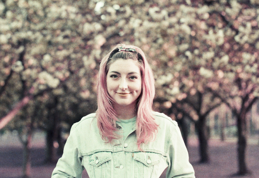

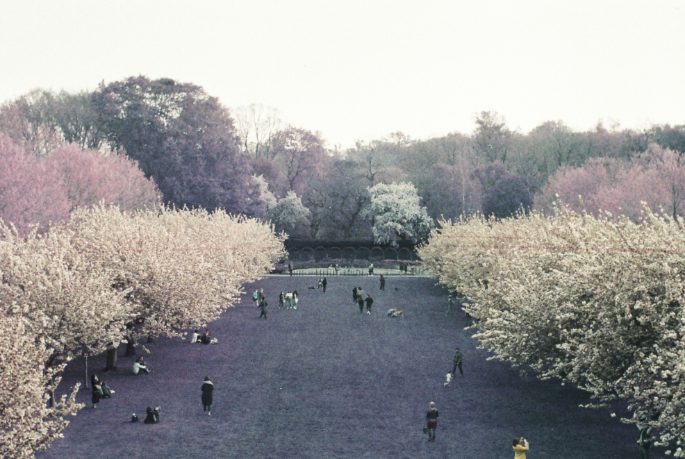

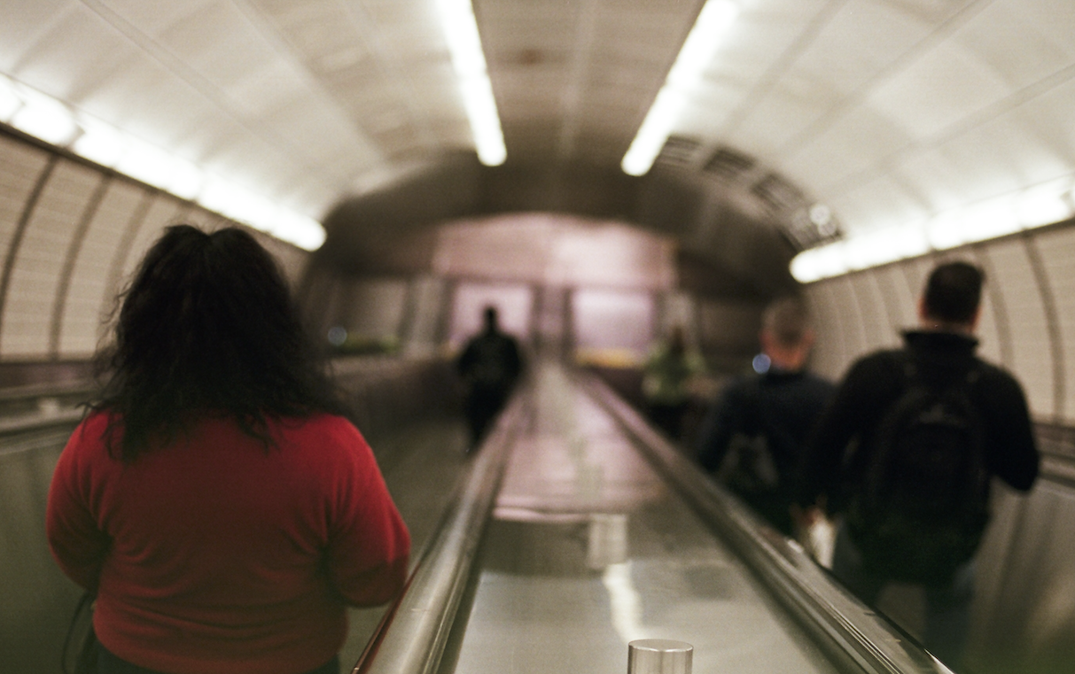

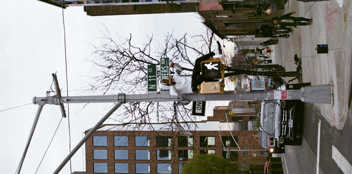

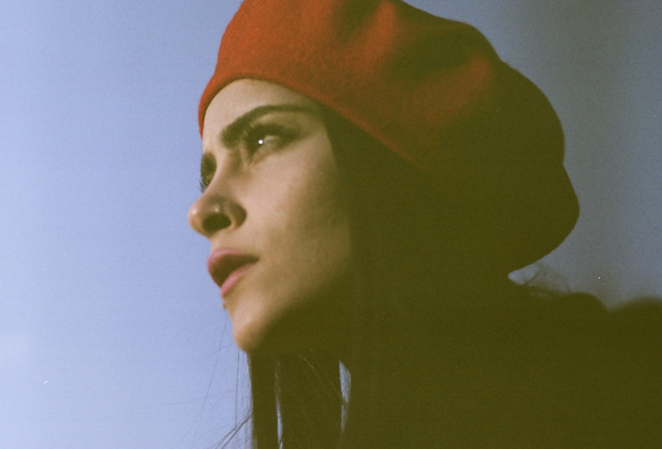

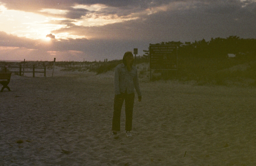

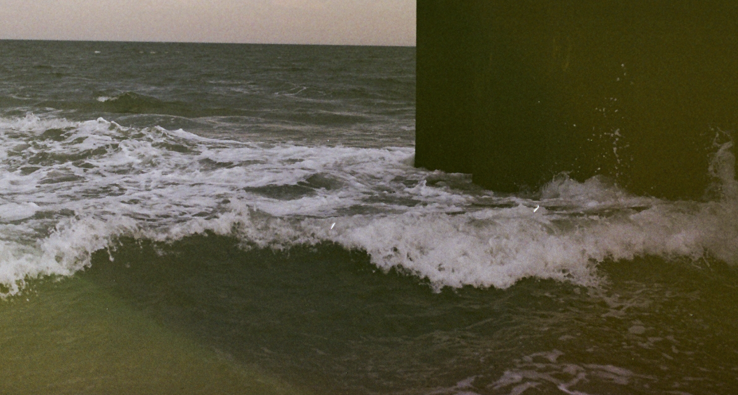

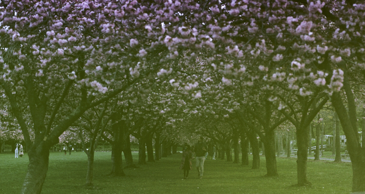

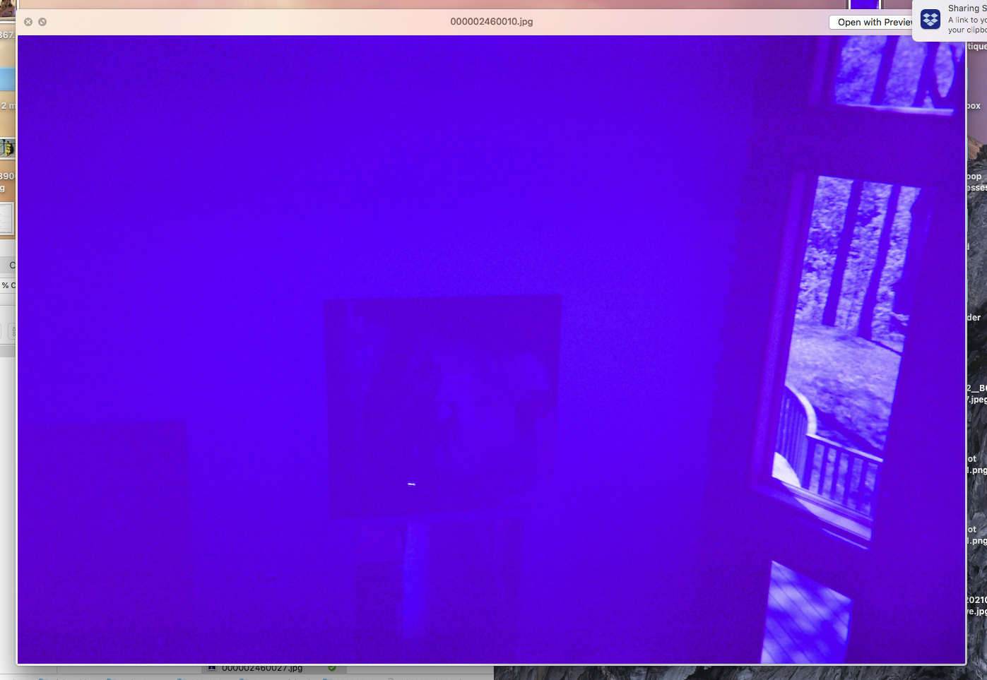

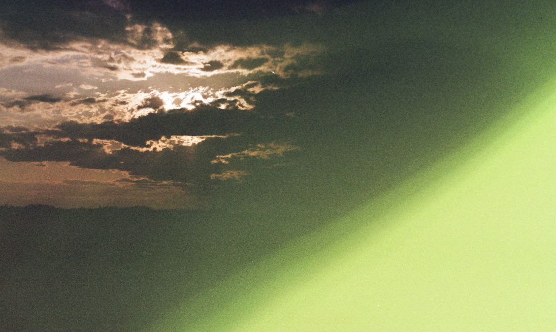

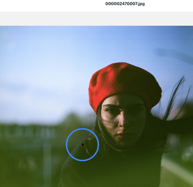

these are three differnt films processed at the same time with the same chemistry in the same tank
It was shipped from the UK to the USA in this "subscription box" of random film sent every month
Does anyone have any clue what's going on here?
the first 4 (top row)are from an expired disposable camera - but still I've never seen such results
the next set of 4 (second row) are from ProImage 100
and the next set of four (third row) are Portra 160
the last three are from "lomo purple"

Looks like you don't have one single cause here. In no particular order:
* Underexposure
* Color balance issues in the digitalization/scanning workflow
* Processing defects possibly caused by film handling issues (film touching during development, muck stuck to film, scratches)
* Partial fogging of film perhaps due to film handling during processing or in-camera problems
* Possibly underdevelopment
Judging scans is always difficult to begin with. The variety of problems we see here makes it extra difficult to nail down the exact causes of your trouble. A thorough review of the entire workflow is in order IMO.

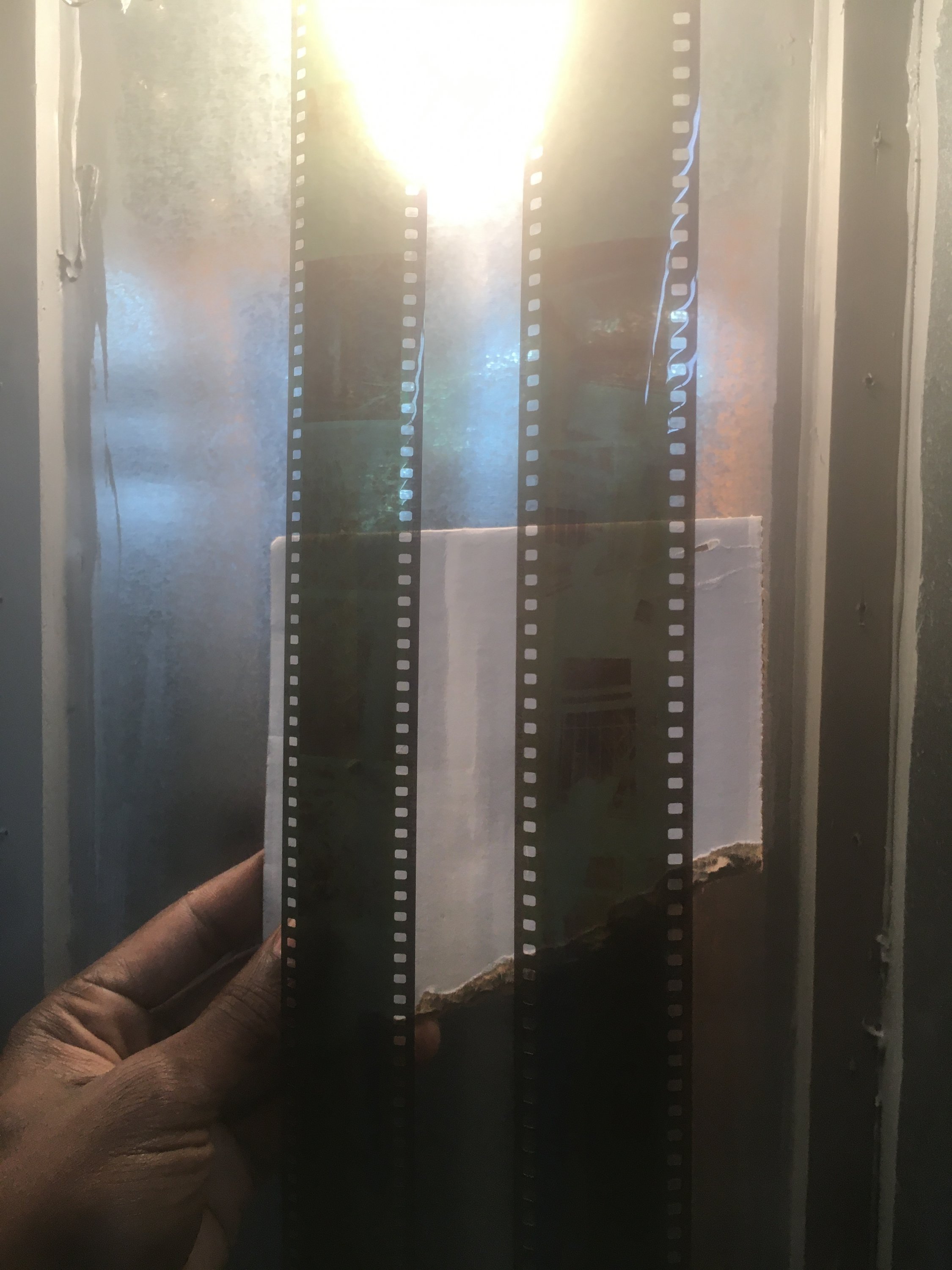

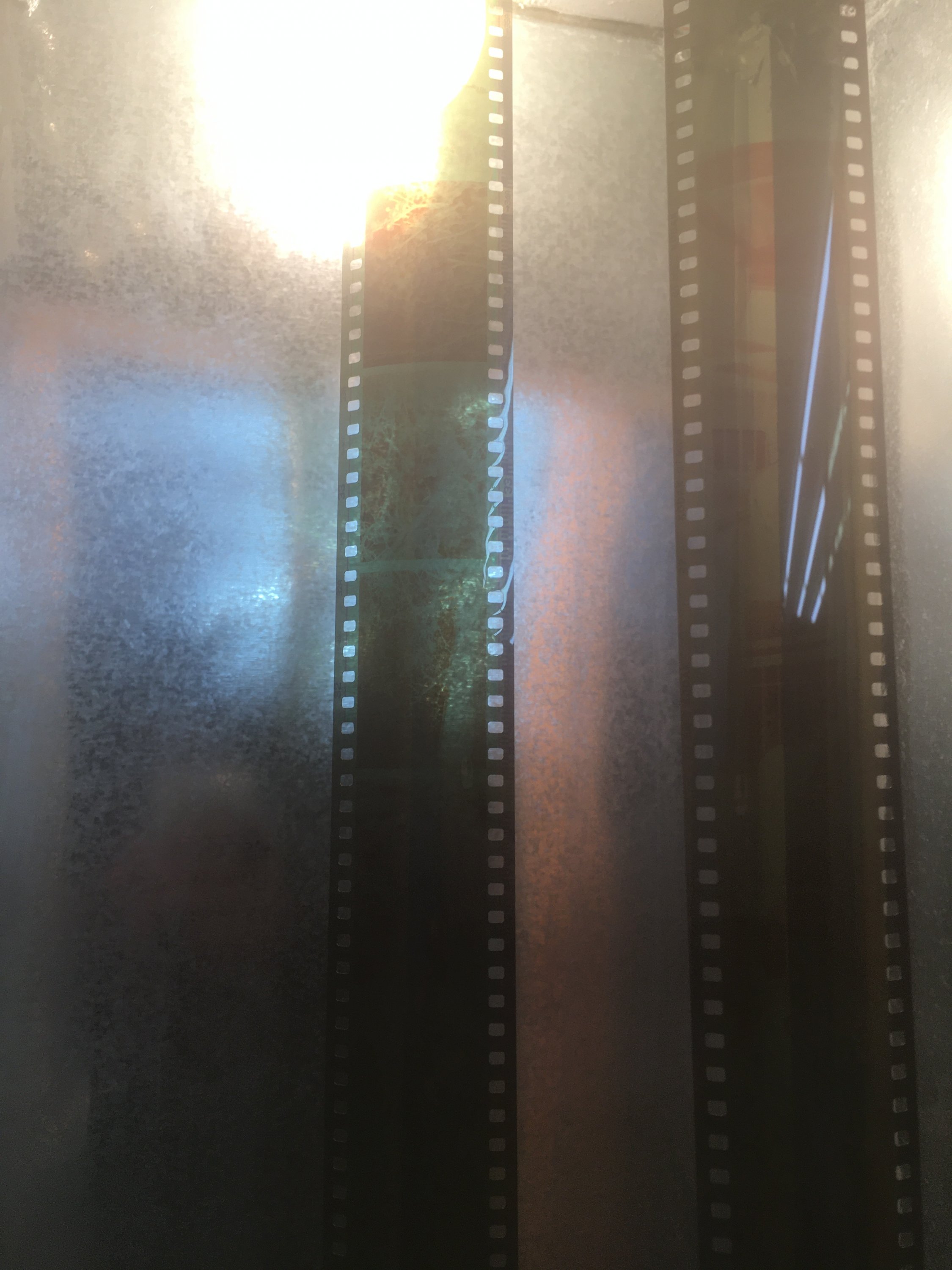

Ok I also have photos of some negatives - these are some that were processed after the fact but still had issues
koraks
Nov 29, 2018
23,663
Europe
Hm, that gives some potentially crucial information - I see a strong cyan cast, which we sometimes see if someone has tried handling C41 film under red 'safe' light. You didn't by any chance make the mistake of thinking that a safelight can be used with C41 film, did you...?

No I didn't, so I have a huge basement and it has two parts. The first par is small and seperated by a door. In the frthest side of the bigger aprt I do the processing. I left the door open on the far side and turned out the lights only in the big part. I come form a black and white film devleoping background so I'm accustomed to packing film in not 100% darkness and still getitng away with what seem to be perfect negatives (to my eyes and when I print I don't notice any fogging) but I guess c41 films are a litle more senstive to the color of the non 100% dark room and also more senstive in genral to light I guess. So no not a safe light, but not a 100% dark room - very dark but not dark enough

Yeah, that's likely a big part of the problem. "Very dark" isn't good enough for C41. It needs to be pitch black, unable to see a thing, not sure if I'm still alive dark.

What I think is the case is that each set of four in the line belong to a different film. So 1-4 is disposable camera film, 5-8 is what ever the Op mentioned etc but I cannot be sure as there are no separate rows. Some shots look close to normal or are in fact normal such as the street scene. Others are beyond any saving and others have strange colours which may be the Lomo Purple.
It might just be that as a couple are OK then it was simply a case of the film being bad or good and had nothing to do with the "not quite darkness" situation or the process.

Shots 1-4 are apparently from a disposable camera, which usually means 400 speed film. Consequently any fog will be more pronounced there than on the 100/160 films. The examples are consistent with this. In the other images it's likely that digital color correction has "saved" some of the images, but wasn't successful on others.
I think the major contributor to the problems is the light fogging in the "undark" darkroom.

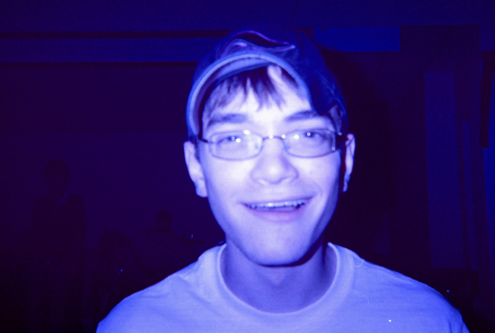

"Lomochrome Purple " has a greenish-purplish base, not the typical orange.
It's the film, not the processing.
It's one of the trendy-boutique "ooh, look at the weird colors...aren't we trendy" films out there, along with the ones with random pre-exposed color fogging.
FPP, Freestyle, et al have a selection of them.
