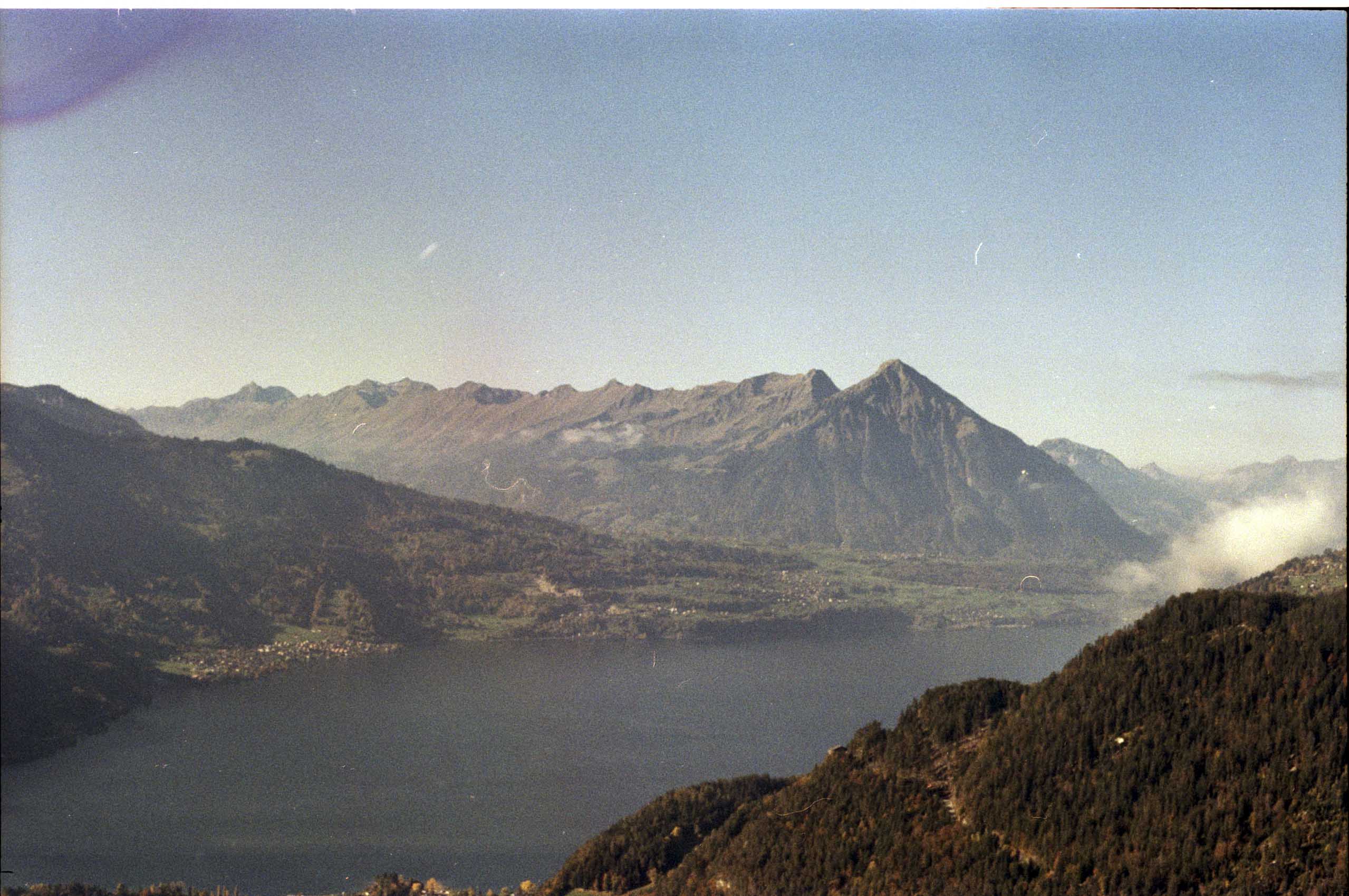

Hi, I've been using Kodak LORR C-41 developing kit to develop color films on my Jobo CPE2 Plus for the past one year. The chemistry that I have is probably expired but worked great till recently until these bold magenta streaks started appearing out of nowhere on the scans. Some marks are so bold that they could be seen on the negative as well. I have tried to read a lot of discussions before posting this but didn't find anything of relevance.
Am I doing something wrong? Or the expired chemsitry it to blame, specifically the developer, bleach or fixer? Has anyone faced such similar issues?

Hey, sure, I can. But I'm out of my lab space right now. Will definitely attach the images of the negatives tomorrow morning.

To give you an idea, there's no suspicious activity outside the frame. For example, no dark spots near or weird colors outside the frame. Although, you can see these pink marks in the frame if seen carefully, these look lighter than the sky color, so it's recognizable that way

Those marks look very much like chemical contamination. Where the come from must be from a tank that is not properly washed out after the las use where some blix may be still present.

The problem presented here is not related to final wash, wetting agent etc. It's either a contamination issue as @BMbikerider suggested, and I also second the idea of @Sirius Glass and @sillo to try a stop bath. 1% acetic acid works well here; the concentration is not critical at all.
If a prewash is used, try leaving it out.
If no prewash is used, try one.
(Some people report best results with a prewash, some without. I'd rather leave that can of worms shut and invite anyone to try what works for them...)
