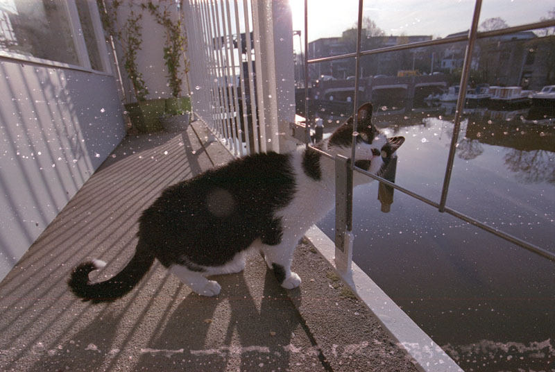

Hi all,
I did my first C41 today. With a kit from Rollei (DIGIBASE C-41 Film Kit for 10 to 12 films). This is a four-bath process: developer, bleach, fix, stabilizer.
The developer goes bad quickly (hours, days). Therefore I saved up 6 films and developed them today, one after the other. 3x 135 (Superia 400, Gold 200, Ektar) and 3x 120 (Reala 2x, Provia cross-processed).

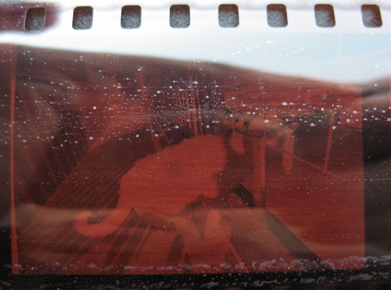

Problem is that the three 35mm films all show pronounced drying spots of some sort. The 120 films are completely devoid of messy stuff. The spots look like mineral residue, but then I did use demineralised water for the final stabilizer bath. I did not squeegee the films, neither the 120's nor the 135's. The spots are on the shiny, non-emulsion side only.
All films were dried the same way: hung up in a dust-free closet at room temperature (18 degrees centigrade or so). No squeegee for any. No rinse after the stabilizer bath. Demineralised water used for the stab-bath, tap water for the other baths.
What's going on? Anybody have a clue? Is this mineral deposit from somewhere? Something from the stabilizer bath perhaps?
Two things are really weird about this:
1. I used demi-water for the stab-bath and still get what look like drying marks from minerals,
2. The 120 films are perfect, and so are the 135 films, but only on the emulsion side- the shiny side is a mess.
The sample below is from the Superia 400 135-36 film. Note: the round whitish blur on Joe's black belly is sun flare.
I'm at a loss- any help much appreciated :smile:

It looks like the stabilizer does not have a good surfactant. I'm regularly battling similar issues because of hard water, but mine is not as bad as yours. Things to try:
* add just a bit of fotoflo to the stab.
* dilute your stabilizer, yours might be a bit too concentrated
* try different stab/final rinse. Kodak makes a good one
* distilled water for the final rinse
* (Don't tell PE about this one) use fotoflo for the final rinse instead of stabilizer. You WILL risk shorter negative lifetime, but they will come out much cleaner for that one print/scan session you are planning to do. Definitely don't do this option if you want archival quality.
On the bright side, the stuff can be cleaned up with PEC pads and PEC negative cleaner. Be super careful since chances of scratching are very high. But please, don't try to clean the emulsion side - that one is sacred!

It looks to me that the stabilizer is faulty. I would complain and ask the manufacturer about these marks.
Some people have reported problems with Tetenal's C-41 stabilizer, not as bad as this though.
I would say Kodak's and Fuji's official chemistry is as bullet-proof as it can get, and if they don't get you there then you should review your drying conditions.
Judging from the bubbles there is a lot of fotoflo in the stab already. Fotoflo is just the same as the wetting agents used for b&w no?
I cut it in half already in order to get to 500 ml solution. Maybe even more then?
I will change to the Fuji Hunt kit *if* I pursue.
Already the case. Well, demineralised water I use, but that should be good enough.
Is this 50 vs 20 years? In that case I won't mind.
[/QUOTE]
I don't like squeegee, let alone cleaning.
Probably not. I think that would be too much.
You can also just buy a bottle of Fuji or Kodak final rinse, and use that with the remainder of your chemicals.
Unfortunately, nobody knows. It really depends on storage. Put it in a damp place and it would be 10 yrs vs 5 days ;-)
I know what you mean. How about re-washing? You could get a good quality final rinse and re-wash the bad negatives. Hopefully it would not be worse than what you have right now.
Also, you mentioned bubbles. That might be a culprit as well. You definitely don't want to over-agitate the final rinse. I just dunk the negatives in the final rinse, and let them sit there for a recommended time. Maybe just a gentle back-forth movement at the most. Then when the time is to take them out, I top off the container with additional liquid to get rid of any bubbles on the surface and only then pull the film out.

Old thread and problem. Good advise here, but one thing nobody responded to: why do only the 135 negatives have this problem? I developed a roll of 120 and 135 together today. both developed fine, but only the 135 had water spots - not as severe as the original poster, but still pretty bad. The 120 film was perfectly clean.
sfaber17
Jun 1, 2014
245
Illinois
The 120 has a gelatin coating on both sides to reduce curl, so photoflow works good on both sides. 135 has the shiny side which can retain drops and cause spots. It is pretty easy to wipe that side off after it dries, but you should use a kimwipe or filter paper to wick off any drops before drying. IMO.

I've had water drying marks on 135 film and not on 120 film too and I don't know why that occurs. However, with the Unicolor powder kits, adding 1/2 tsp. of PhotoFlo concentrate to 1 liter of stabilizer, and repeating every 8 rolls developed, has eliminated water drying marks.
