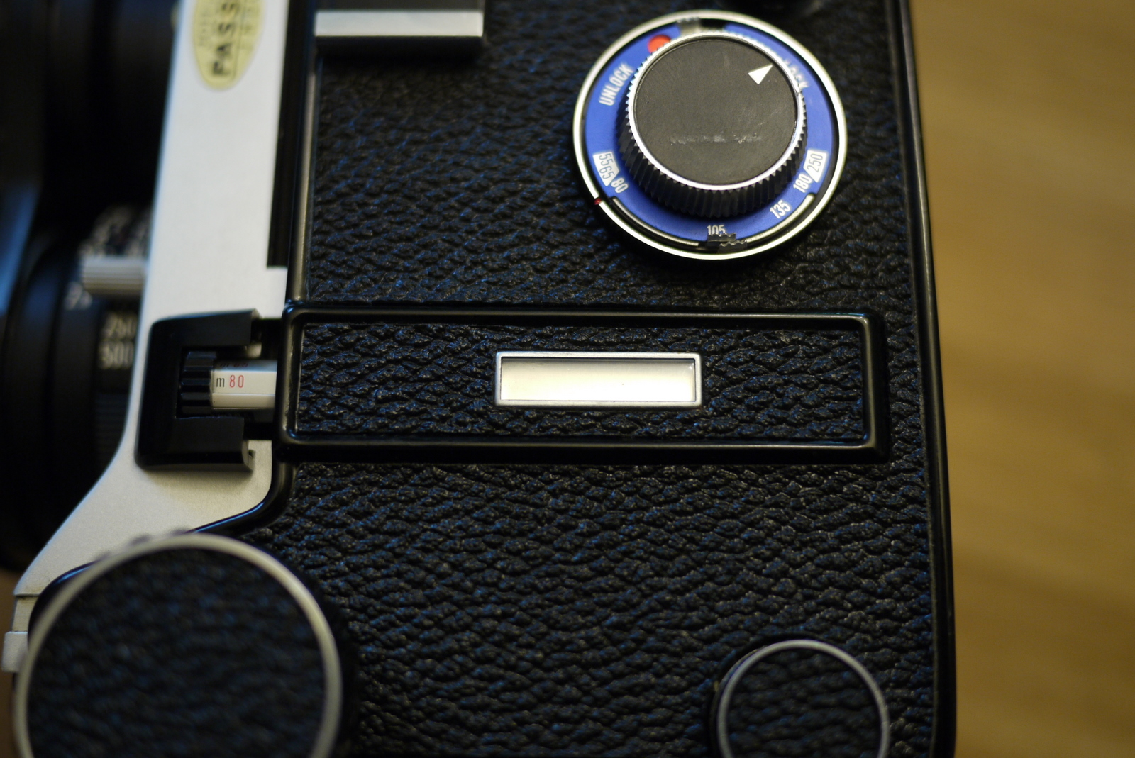

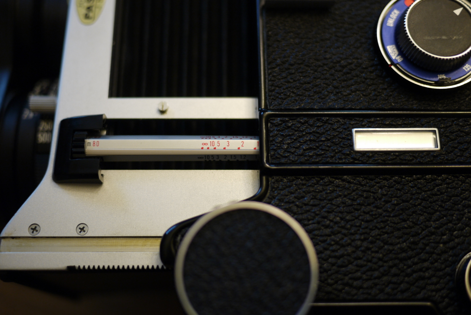

I have just purchased a C330 with a blue dot 80mm lens. It appears to be in very good shape (bellows look new, light seals are flexible, tracks look new). I haven't run any film through it yet but it looks like a keeper. The only issue is that the distance scale doesn't show up in the view window. I removed the scale and tried to peer down the tube but couldn't see anything. I have attached two photos. One shows that the scale does actually exist :smile: and the other shows the camera focused at a distance less than infinity.
Anyone know why I can't see the scale as the manual says I should? I know that it isn't vital but it would help me verify my focusing skills.

I have a C-330 S, there is a moving curtain that slides from front to rear as the focus is moved outward. Yours may not be functioning, it needs to move as you focus closer. When bellows is fully retracted there should be numbers visable, and as you focus the curtain should move toward the rear.

The moving curtain/shutter on the C330 is spring loaded. If that part is damaged, the shutter may stick closed, thus obstructing the distance scale.
My sense is that this problem isn't particularly unusual, as you see it from time to time in KEH listings for the camera.

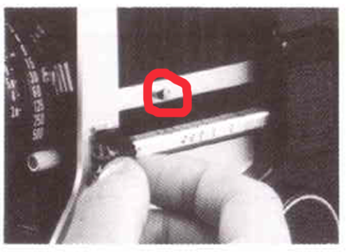

Give this a try.
The white piece you see blocking the window goes behind the scale rod (IIRC). Yours seems to be laying on top of the scale rod in the window. Follow the attached link, (pg 20-21 (?). Remove the scale rod; use a small piece of wire to lay the white tab towards the interior of the camera; re-insert/re-install the scale rod with the white tab behind the scale rod in the window.
I think that white tab is more of a bearing surface, and may not cause much, if any problem, if it were removed entirely.
http://www.cameramanuals.org/mamiya_pdf/mamiya_c330s-1.pdf

The distance scale shaft is not what makes the window move. There's a little latch activated by the protruding screw more on the upper strut, in red on the photo.
I tried pushing the little latch by hand with a trombone, but to no avail. The linking mechanism between the latch and the moving window must be uncoupled, and that would probably require opening the side of the camera.
