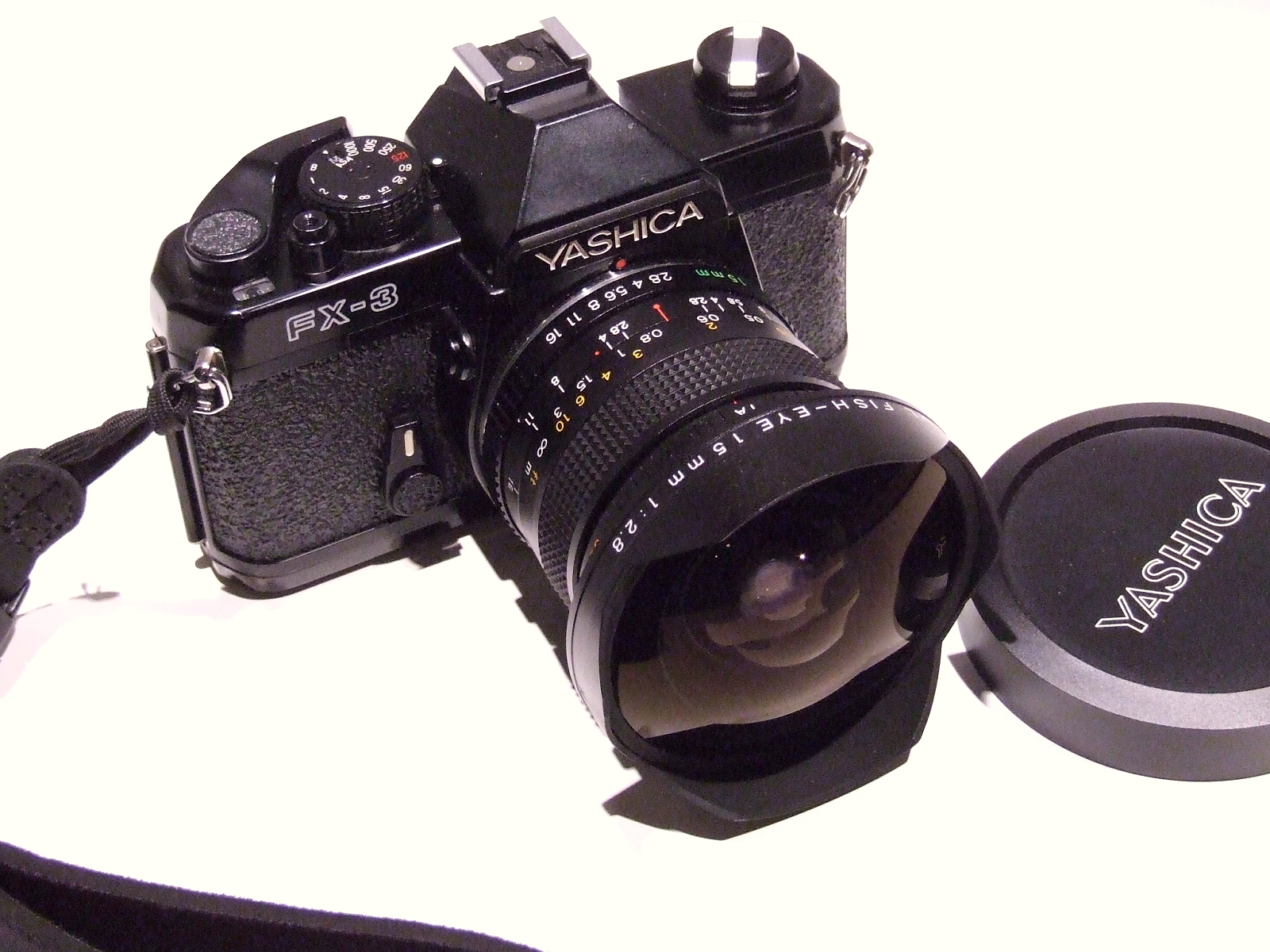

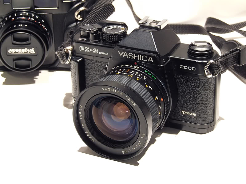

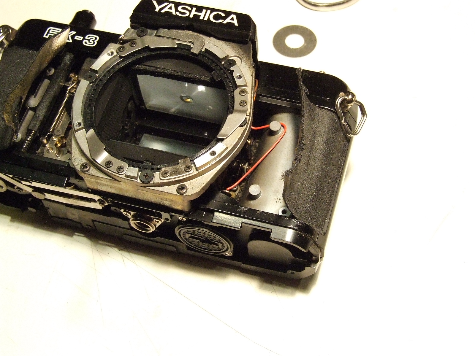

I have a modest collection of Yashica bayonet mount cameras and lenses. If my count is right I have had three FX-3 cameras overhauled and one FX-7. I also have two working FX-3 Super 2000s and some other FX-3 and FX-3 Super bodies in various states of repair. An FX-3 is a simple camera. You have to push in a small button on the back of the top plate to activate the meter. I think the FX-3 is better made than its later variants. It has a bright finder. FX-3 and FX-3 Super bodies are usually found with disintegrated skin. They are easily re-covered. My favorite material for this is a LifeSafe product called Soft Textured Vinyl Traction Strips (Non-Skid). I get the 4X9" size, 2 to a pack. They have adhesive on the back but my repairman removes the adhesive and applies the skin with Pliobond. No peeling so far. My FX-3s are covered with the black color vinyl while the FX-7 has the medium gray color. I got the material from Koffler Sales. My Y/C mount lenses are a combination of Yashica ML, Yashica MC, YUS, Yashica DSB, Kiron, Vivitar Fixed Mount, Vivitar TX, Tamron Adaptall II (regular and SP), T Mount ad M42 with adapters. The FX-3 is light but reasonably rugged. I wouldn't drop it onto a Nikon FE but it's strong enough. It also doesn't cost very much and battery life is good. The later Contax SLR bodies are more exciting but when they all stop working, an FX-3 will still be taking pictures somewhere.

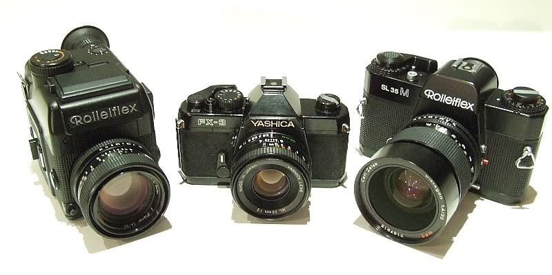

YashicaFX-3. I have a few of them and they have proven to be quite durable and trouble free. It is a tiny, fully mechanical camera with LED TTL metering using common batteries.
I like the last picture. It shows three 35mm cameras that take similar Zeiss lenses, but the FX-3 makes the Rolleiflex cameras look like Medium Format!

Now you're talking. When I use an FX-3 Super 2000 I try to handle it very gently. It has many plastic parts inside, especially gears. The original FX-3 is better made and easier to keep going than any of the Contax SLR models. For times when you can live with 1/1000 as your top speed, the FX-3 will serve you well. There is an in-between model, the FX-3 Super. I haven't had one of those overhauled yet. The FX-3 shown has a nice new covering. It looks like my overhauled FX-3s. My FX-7 has the same covering but in gray.
