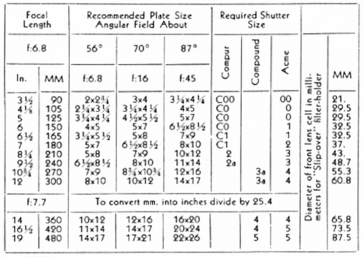

Mustafa Umut Sarac submitted a new resource:
(there was a url link here which no longer exists) - C P Goerz AG Dagor f= 30 cm 1:6,8 and f=36 cm 1:7,7 Design Paper
Zeiss Archive paper , only Goerz paper remained in all Zeiss Archive. Find attached paper.
By the way , It would be very nice to see images and pictures of above lenses If there is any owner one of these lenses.

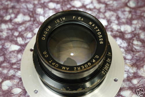

Hello E. von Hoegh,
Can you please share your best quality shots for evaluating the lens,
Thank you.
E. von Hoegh
Sep 14, 2011
6,197
Adirondacks
Hello E. von Hoegh,
Thank you.
I'm sorry, I have no way to scan negatives at anything approaching the quality neccesary to evaluate the lens' performance.
But I can say I've been using it for about 20 years, with b&w and some color transparency - Kodachrome 64 in 120 size for product photography, in the studio - and it's a superb example of a Dagor.
