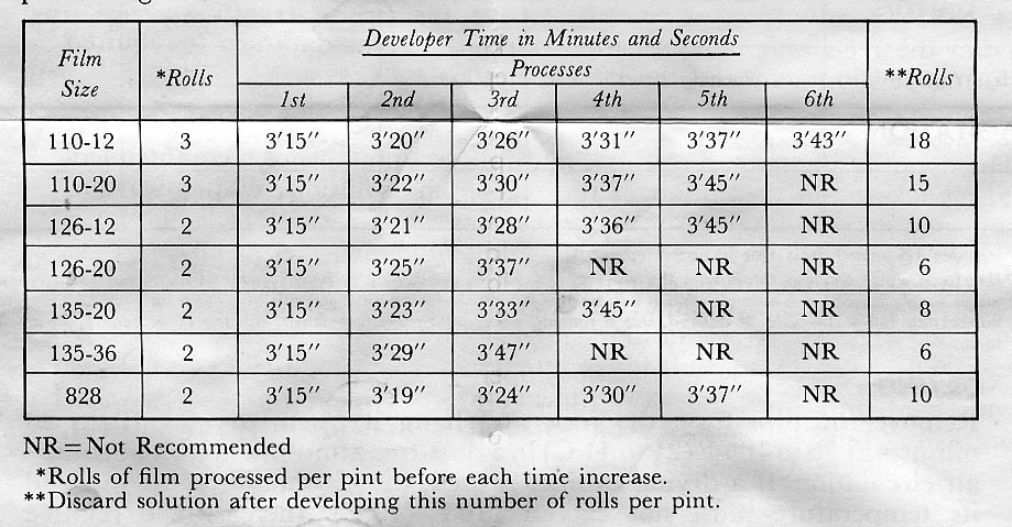

Here are the instructions packed with my C41 developer.
Note that it says running water. Well, with my drum I either use about 3 changes to 6 changes of water or I remove the drum and put a hose into the tank.
The water should run clear and the final rinse should not discolor if the wash is complete.
PE
Thanks for your reply, PE. These are helpful instructions you attached. They seem to be oriented toward small tank hand inversion processing with chemical re-use. I am curious though as to the difference between these instructions and what is in the current pdf z131_03 for rotary processors. Is it just supposed to be implied that the 3:00 wash is done using a series of changes of water? I can't find that stated in the Rotary processing section.

My instructions say running water. My rotary tank instructions (Jobo) say changes of water. I do either. Usually changes with small tanks and running water with multiple rolls. The point is that the wash water should be clear, and the final rinse should not discolor. Those are the key points. And the reason for this is the same as for B&W. Good image stability!
PE
