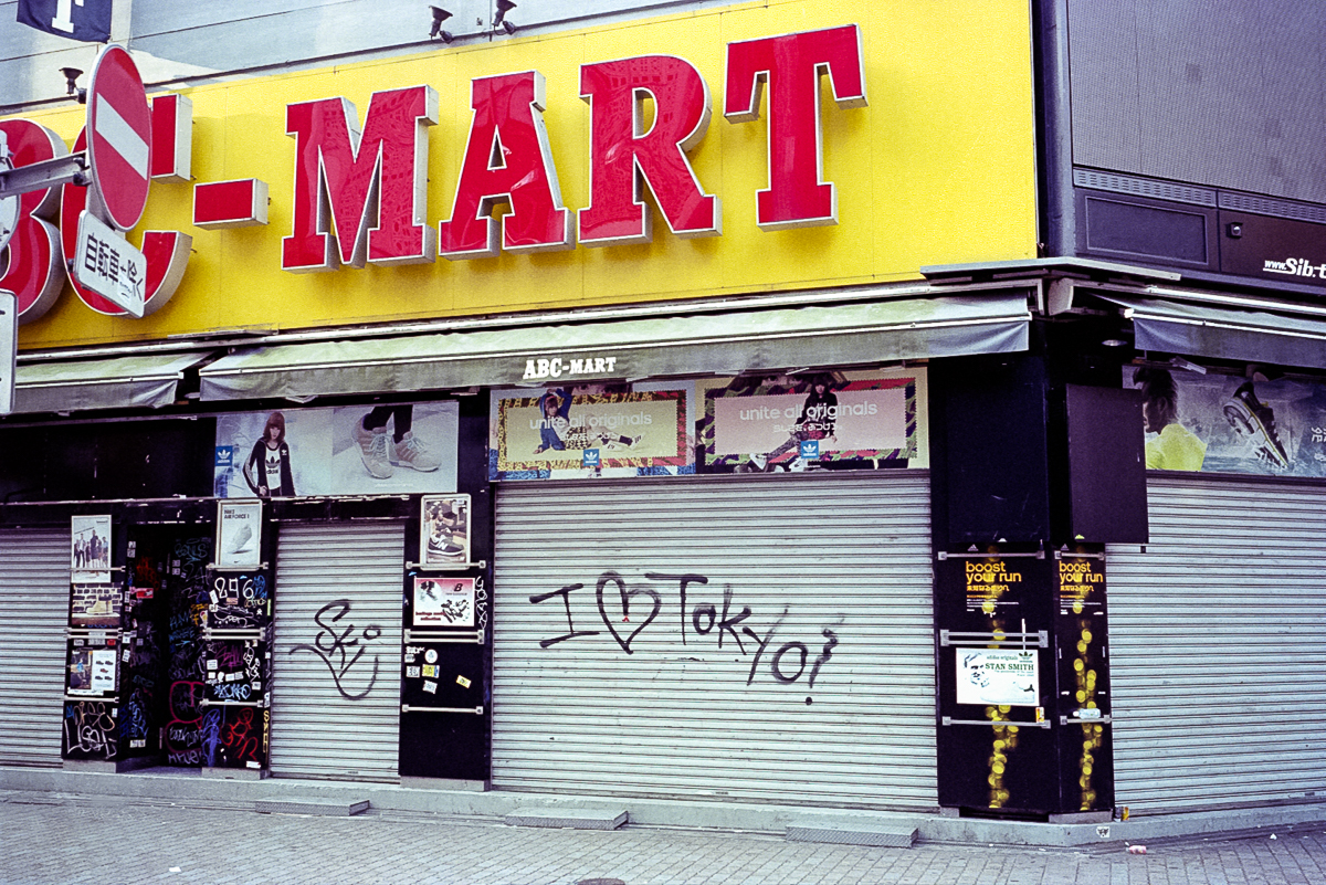

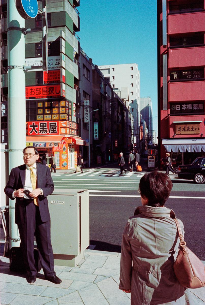

Fujifilm Natura 1600:
attachment.php
attachment.php

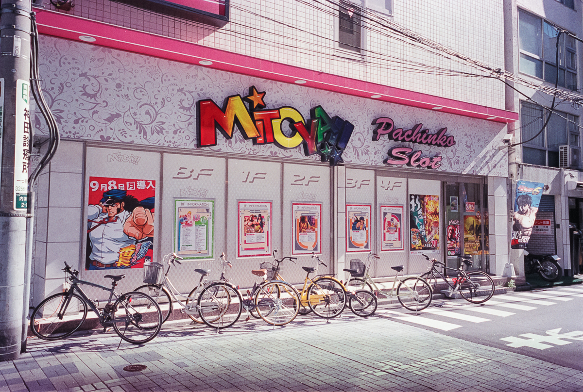

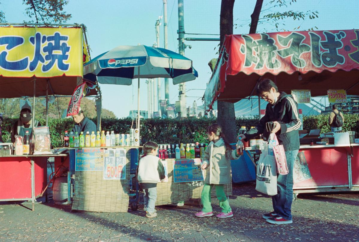

Portra 400:
attachment.php
attachment.php

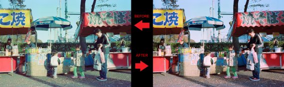

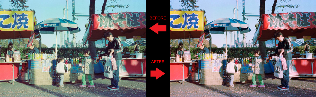

allow me, if I may, to simply do a simple color adjustment on it(file uploaded below)
I simply did a slight curves adjustment to the supplied file, to provide a pleasing(to my eye at least) color balance, compared to the very heavy cast on the original file.

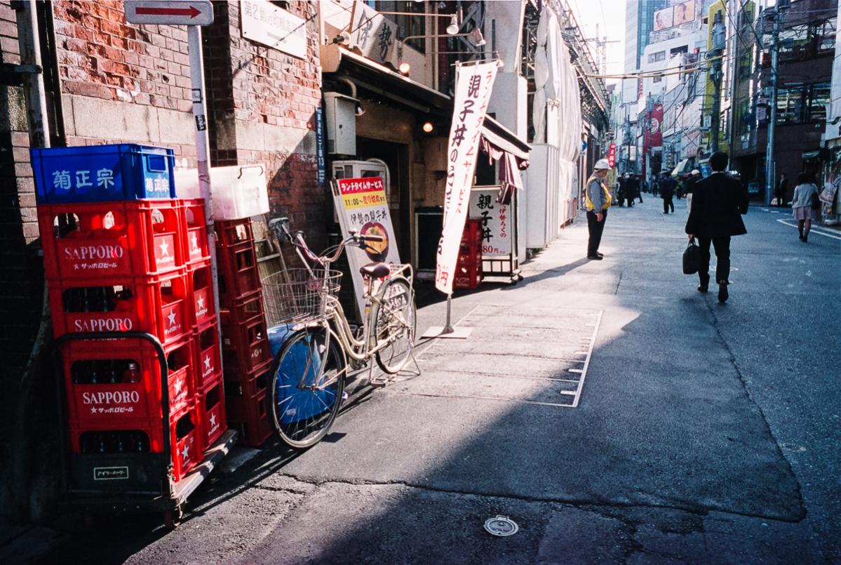

Haven't had a chance to print the portra yet, but ran another roll of portra 400 through the same developer. This time I did a two minute pre-soak and increased the agitation from every 30 seconds to every 15 seconds.
Same scanner, same default/auto settings and I get something that looks a little better to my eyes. I will still have to print both in the dark room to see if that really made the difference.
attachment.php
