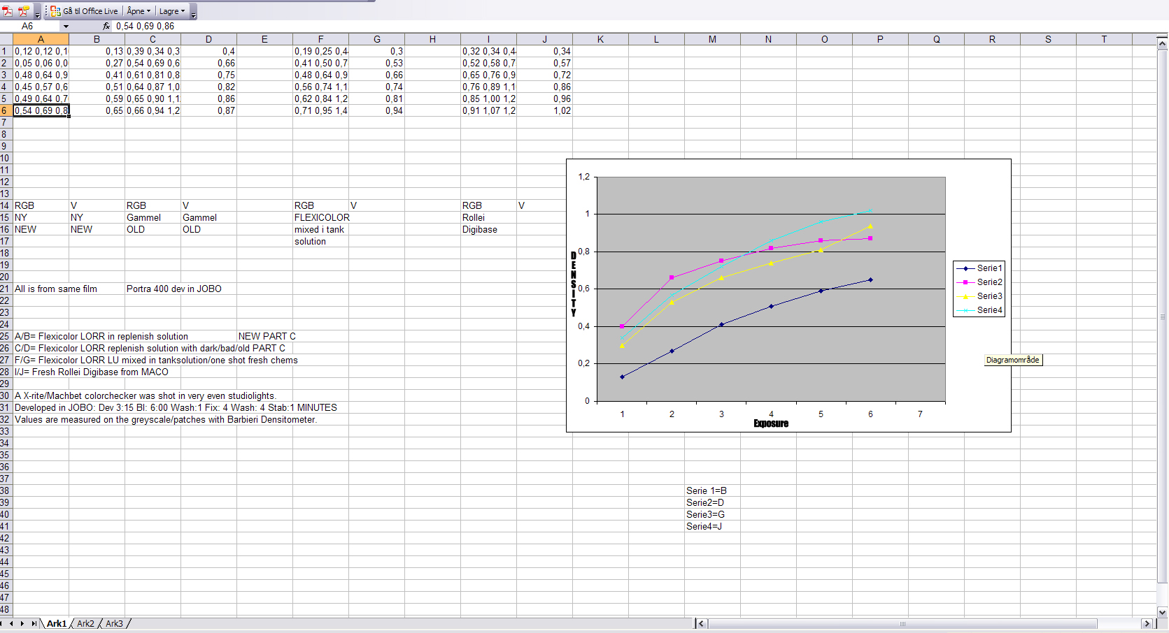

P E: I have used Digibase C41 for a long time. Now im having a big batch of Flexicolor LORR Replenisher developer ill try to match Digibase. First i mix one litre replenisher solution who then is mixed down to tank solution with water and starter. Used in a JOBO for 3:15 6 min bleac (RA) Then C41 RA fix. All wash cycles.
I have done some densitometer readings. Looks like i add to much water, but following KODAKs advices from their tech pub on it, Can you see out from my added curves whats wrong?
The density readings are from machbet/x-rite colorscheckers neutral steps.

In the exelfile, there is a y/x-axis with exposure/density chart/diagram. JPG screenshot is added here

Well then, that is what is confusing me. Those curves look nothing like any C41 film curve I have ever seen! And so, I cannot give any real conclusion to you about this.
A C41 curve set should be a trio of parallel or near parallel lines with yellow on top, then magenta and then cyan where the cyan occupies the position of a normal B&W film H&D curve. I see little resembling that here. Sorry.

Im not good enough with exel to plot the RGB-values into a curve system. So only the neutral densities is in the curve graph. All the RGB in respectly order, are in the columns with letters.

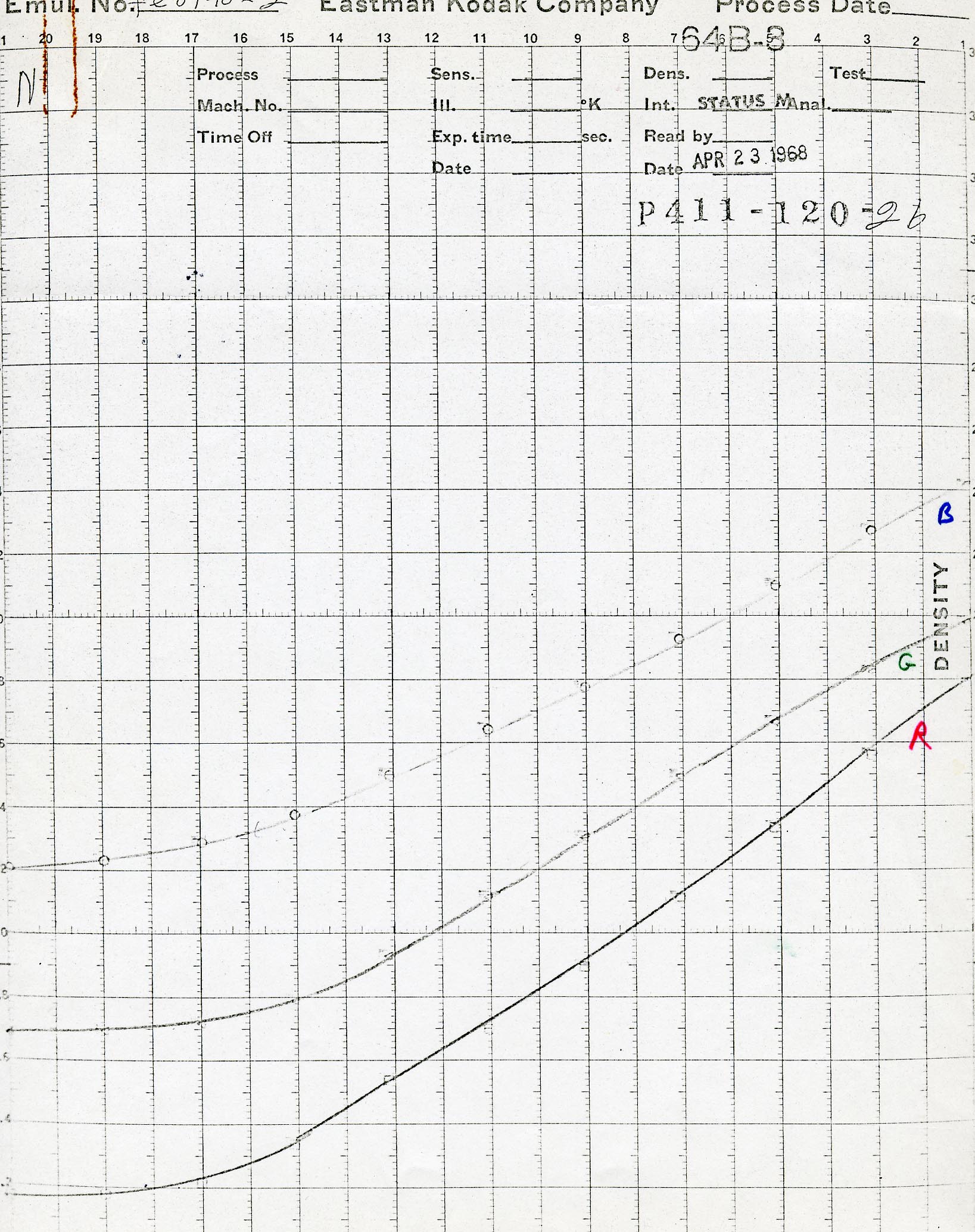

The attached curve should give you an idea of what a color negative film curve looks like. This is an experimental coating that has severe defects causing crossover. I dug one out of an old file for you.
Your reading of a step scale in R/G/B space should resemble a portion of this curve, either better in shape or worse. You should have 2 sets of 3 curves, one with one chemistry and another with the other chemistry. This is needed to make any sense of what you are describing.
