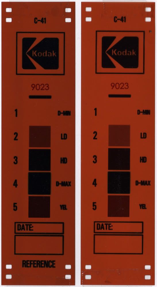

My first attempts at C-41 processing with a tetenal kit were mildly successful, and I've since moved to using kodak developer and a separate bleach/fix. I had horrible color shifts and stains at first, which I attributed to insufficient washing between dev. and bleach (I'm using a ferricyanide bleach). Here's a control strip that I just developed next to the reference strip:
The base is a bit more orange and a bit lighter. You can't see it on the scan, but the black is darker on the reference than the one I developed, so I'm suspecting underdevelopment.
I've been doing my processing like this:
1. Pre-soak @ ~100F / 1-3 minutes (while I wait for the developer to heat up)
2. Develop @ 100F / 3:15 minutes
3. Stop @ ~100F / 1:00 minute (acetic acid, pH = 4.5)
4. Wash @ ~100F / ~3 minutes
5. Bleach @ ~100F / 6:00 minutes
6. Wash @ ~100F / ~3 minutes
7. Fix @ ~100F / 4-5 minutes (TF-4)
8. Wash @ ~100F / ~10 minutes
9. Stabilizer @ ~100F / 1:30 minutes
I noticed that 1 minute is usually the recommended time for the pre-soak. Will a longer pre-soak mess things up? Other than that, I'd suspect my temperature is off. I only have one thermometer and no way to tell how accurate it is. Can anyone enlighten me?

I presoak for random times. As long as the temperature is high enough I think you're good.
You might try heating the water bath to 102 to compensate for heat loss in transfer. As a feeble ballpark test, get a glass of ice water and stir it and use your thermometer to read it. If it's far from 32 degrees you have problems.
As far as I'm aware using Ferricyanide bleach and non-color fixer is detrimental to the final image. To what extent that occurs, I have no idea. I would recommend finding Bleach III or SM from kodak and see if that makes a difference. Color fixer is also very cheap, so I would recommend using that.

I'm pretty sure the (biggest) problem is temperature. I found another thermometer and the difference was about 5 degrees (F).

Where are the color patches? That might help.
But, it does look like underdevelopment. OTOH, this film series was not designed for a ferri bleach with a clearing bath. So, IDK what is really going on here.

Color patches? The only thing the box contained was a pre-processed strip and several sealed pre-exposed strips of film.

You need a stop/clear between the developer and the bleach. See my other post on this!

I get the sense the stop and clear is only necessary with a ferricyanide based bleach. It's not specified in the actual c41 process because the bleach performs this function on its own.
Mar 17, 2009
420
Yeah, its unnecessary if you use the normal kodak bleach. I'm just too poor to buy the real stuff.

You should change your stop to one that contains sulfite to neutralize the color couplers. PE mentions this is other posts. Make your stop 1-2% acetic and also 1% sod. bisulfite. Yes, it is rather odorous but better safe than sorry.

I would recommend a longer wash between the bleach and fixer, maybe 5 minutes or more with the ferri bleach. Not to solve your problem, but in general. The D-min areas seem clearer when I do than the standard 3:15.
To be more precise, it scavenges any remaining color developer to prevent coupling in the strong ferri bleach.

A ferri bleach, used properly should give good strip results. This is taken from Kodak's process control literature concerning testing for retained silver and leuco-cyan dye:
"2. Rebleach the control strip for 5 minutes in a known
good bleach (i.e., a properly constituted Process C-41
bleach or a solution made from KODAK Farmer?s
Reducer, Part A)."
Part A in Farmer's Reducer is potassium ferricyanide.
Using a control strip and a densitometer always makes sense, the whole point being knowing just how close you are to the real thing, and when it is necessary to make changes.

1. I believe that you are making a mistake by pre-soaking the film. Moth Jobo and Kodak recommend that you bring the drum up to processing temperature by rotating it in the trough for 5 minutes and do not use a pre-soak.
2. Both Jobo and Kodak recommend a 3;15 development time @ 100.4F
3. You don't need a to use a stop between the developer and bleach according to both Kodak and Jobo.
4. Both Jobo and Kodak recommend a 6:30 bleach cycle. I wouldn't short it.
5. Jobo inserts a 3-minute wash between the bleach and fix step (6 changes of water). Works fine as far as I can tell.
6. Both Jobo and Kodak recommend a 6:30 fix cycle. Why short it?
7. Jobo recommends a 5 minute final wash with 6 changes of water.
8. Jobo recommends a 1-minute final rinse/stablizer off processer. Kodak recommends 1:30.

When using a ferri bleach, some type of stop bath is absolutely necessary between the developer and bleach. Any developer carryover into the bleach will be oxidized by the ferri, causing a bad stain.
A long wash or clearing bath is recommended after the ferri bleach to prevent reaction with sulfur in the fixer, resulting in fogging.
