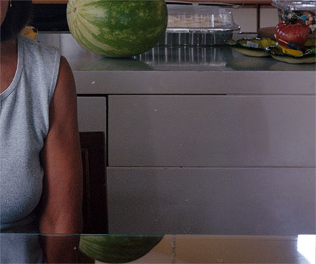

I am processing 4x5 sheets in a Jobo Expert Drum using Kodak C-41 and the minimum chemistry (210ml) for the drum one-shot. Getting stains and streaks that are sometimes visible in the film, sometimes not. The drums are not leaking. (that had been a problem once with E-6) I am using a wash between all of the steps. Using the recommended rotation speed for these drums and temperature. Attached is a section of a film. The stains are in the direction of rotation. I am using a pre-heat and a pre-rinse. i do not think I had the problem on previous batches but since they are not all scanned, it is possible that I missed seeing this. Only have two ideas. One is to increase the speed which I do not think will help. The other is use more chemistry. Hate to do this since Kodak is making this stuff very hard to get and very expensive. As in I had the fixer back ordered for nearly three months with Calumet and when it came the bottles were 5L rather than 10L and 30% more per bottle. Any ideas would be appreciated.

This almost looks like a shadow not a stain.
However, if it is truly a stain, make sure you use a prewet and use a stop after the developer.

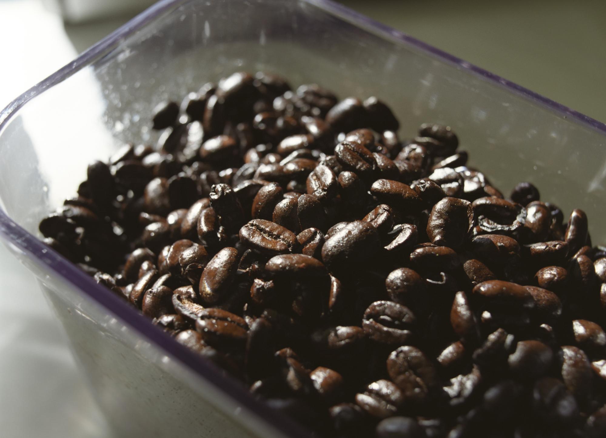

Thanks. I just ran a roll through in which I used a stop bath between the developer and bleach stages. I will post a scan later today or tomorrow.
Wow! What a revelation. The stop bath makes a huge difference. See attached (not art, but was available):

This indicates though that there was some other underlying problem such as too little agitation, too little solution in addition to the fact that there may have been no prewet. The stop will correct for the first two, but not the last.
PE
tnabbott
Aug 28, 2010
623
USA
PE
I can probably rule out a couple of the suspects. I ran the entire process on the Jobo, so the agitation was probably sufficient. I also can confirm prewet. This leaves the possibility of too little solution. I suppose that could have occurred; however, I attempted to measure the 270ml required for the Jobo tank I used. Is it possible the stop bath makes a difference because of the acidity level of the tap water in my area? Just thinking out loud here...
