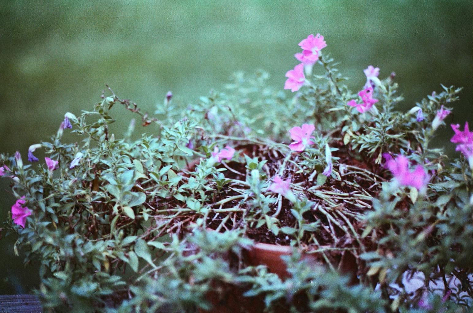

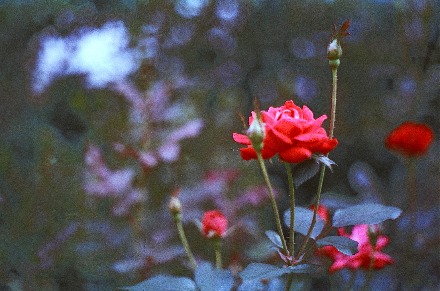

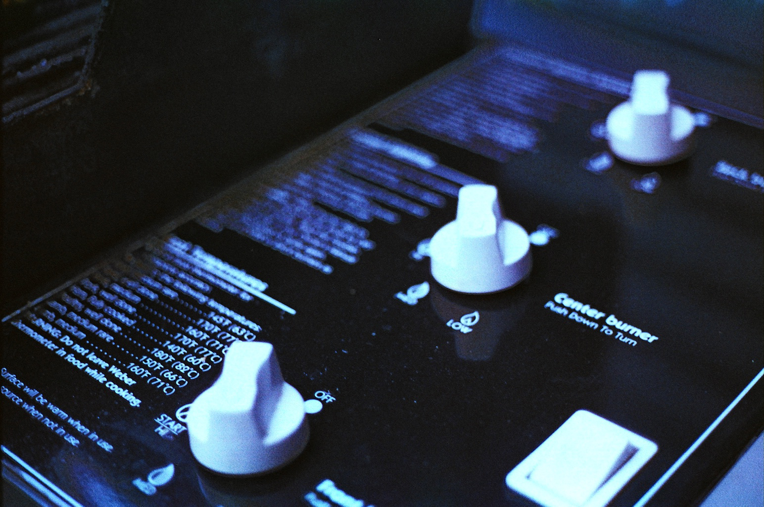

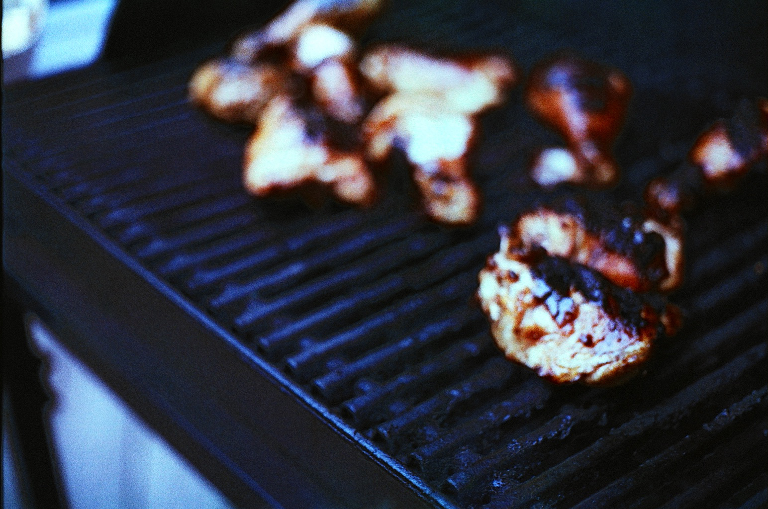

Ok - so here are a few of the shots, inverted in Photoshop ... yes I know that that's a dirty word around here.

Grainy, but very interesting. The colors don't appear true, but it is a fascinating effect.
Whatever on earth made you think of trying this?
