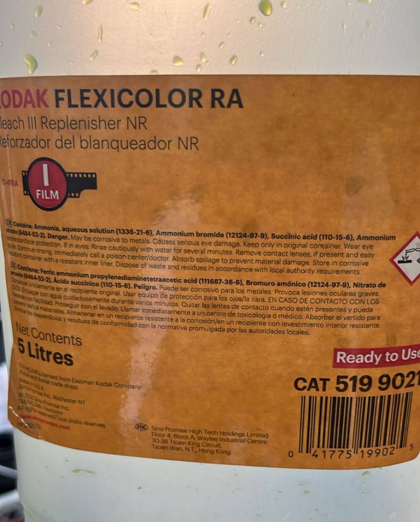

I’m currently looking into making a PDTA bleach based on the Kodak patent but Acetic acid is extremely restricted here in Brazil.
I’ve been wondering if substituting it with Ammonium acetate as instructed in the ECN-2 PDF would be the best solution,
“One mL of glacial acetic acid is equivalent to 1.05 grams of glacial acetic acid. One millilitre of glacial acetic acid can then be replaced by 1.35 grams of ammonium acetate.”
or if could replace it with Sulfuric or Succinic Acid as i’ve seen it listed in a Flexicolor Bleach iiii RA bottle.

Do they sell cleaning vinegar in stores in Brazil? This is a fairly weak solution of acetic acid, usually around 7-10% or so. But that should be enough for your purpose.
I think you could indeed substitute the acetic acid with acetate and a little sulfiruc acid. Then again, it's kind of odd if you can obtain sulfuric acid easily but don't have access to acetic acid.
Either way, note that you don't really need glacial acetic acid. Pretty much any concentration will be fine; you just have to calculate how much to use based on the concentration you can obtain.
Alternatively you could use a simple and cheap ferrocyanide bleach as well. Although it's not really known what this does for the longevity of the negatives, it does work.

Thanks Koraks! been reading the forum for a little over an year now but only now registered.
i currently use a ferricyanide bleach with my ECN-2 and C-41 process, but i’m running a very small operation developing film for other people and i’d like to simplify the process (and improve it) Acetic acid used to be easy to get even in glacial form from my research but nowadays anything over 10% generally requires a license from the federal police. from my calculations the minimum i need is 15%, i’ve been inquiring about a 20% solution from one place but i haven’t heard back yet. everyone else requires a license over 5%.
Sulfuric acid can be easily obtained as battery acid here
Won't 10% work? What's the concentration you need in the final working strength bleach? And do any of the other ingredients come as a liquid solution?

it seems i was misremembering and it would indeed work.
515.2ml of a 10% solution to make 1000ml bleach.
this concentration might still require a license but i managed to find cleaning vinegar at a 8% solution. adjusting to 644ml.
i assume this shouldnt be too close to the limit once the other ingredients are dissolved?

I expect it should work, really. If you have trouble getting everything into solution, warm it all up to 50C or so. But I don't think it'll be an issue even at room temperature if you stir well.
The 8% concentration will likely be just fine. I'd give it a go, see how it works.
My advice is to keep the stop bath so that the pH of your bleach won't drift upwards too much due to developer carry-over.

Since you start this with PDTA free acid, you can most likely use Ammonium Acetate instead of Acetic Acid, and just add less Ammonia to get pH to target. The main purpose of Acetic Acid in this mix is its buffering between pH 4 and 5, so Ammonium Acetate will likely work well.
PS: the formula you must must be a very rapid bleach, and you should be able to work with a much diluted version of it. 1+1 and 1+2 would be good starting points, PDTA is not that cheap.

My own bleach III like concoction definitely does bleach in 6 minutes @38°C/100°F. It may be much faster, but I never bothered to check. Regarding EDTA vs. PDTA: both bleaches last for about 6 months, after which they begin to look messy. By this I don't mean just discoloration, this you will have after the first use. I mean it looks like "the iron is not happy in there any longer and wants to get out". If you process fewer than 20 rolls in this time frame, and if you process E-6 anyway, then a single Ammonium Ferric EDTA based bleach would be your best option.
Both C-41 and ECN-2 are rated for Ammonium Ferric EDTA and the more powerful Ammonium Ferric PDTA. If you don't have E-6 to process, and if PDTA is not much more expensive than EDTA, then the more dilute PDTA bleach is likely the cheaper option, especially, if you also save the bleach accelerator.
If you process more than 20 rolls in six months, and if you have both C-41/ECN-2 and E-6, then a dedicated bleach of each type would probably be the most economic option. With pH adjustment in regular intervals you may keep the E-6 bleach in good shape, maybe even for a whole year.
