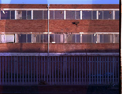

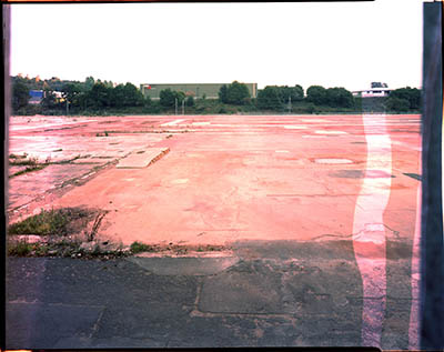

Hi all,
(Long time lurker and have learn't a lot from APUG in the past few months)
Wonder if anyone could let me know whats happening with these two 5x4 Ektar negs?
They have come out the 2 separate runs and the other 3 negs in each run came out perfect.
I'm using a Jobo expert drum with no pre soak and the digibase C-41 kit as one shot, following the instructions as printed, using 250ml dev.
Rotation is around 50rpm, one way. Can't understand why the other negs are fine and these have streaks across them?
(I've tried a re-bleach and re-fix)
(Please excuse rubbish scans, had a long day and yes the ground should be red and the line on the right is some railings)
Regards
Ed

Those are developer streaks. The developer is not wetting the film evenly and probably the temperature is not fully up to 100F.
It may also be made worse by slow (one way?) rotation. (did I read the OP right? One way rotation, not oscillation?) Slow or one way rotation is not good. Jobo listed an updated rotation recommendation quite a few years ago in which the larger the tank diameter, the higher the rotation rate. This is logical. I now use 5 or 6 for the back and forth rotation of my drums.
You should never use one way rotation!
A prewet does not hurt. See the thread where someone tested drum temperatures with and without prewet.
PE

You did not mention which expert drum you are using. Make sure you use enough solution. The 3004 and 3005 require 270ml of solution, so your 250ml of developer could have been the culprit as well if you used one of those.
Also, I'll second the presoak recommendation, works like a charm.

I've done a few more runs and a 2x30sec presoak resulted in the same problem, a 5 minute one, and problem solved.
I've also decided to start agitating again, at the risk of (eventually) blowing the motor.....
Many thanks for the help.
