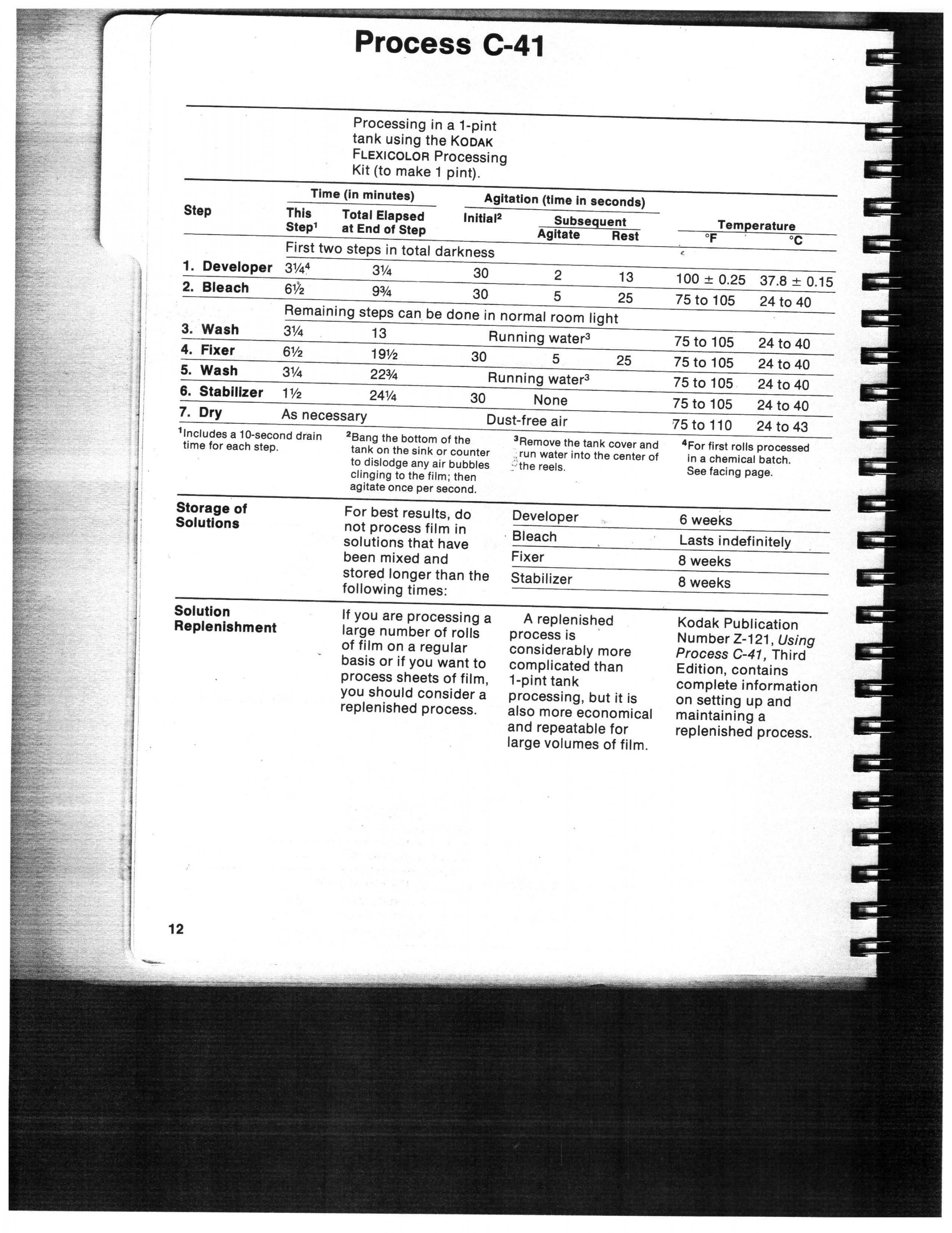

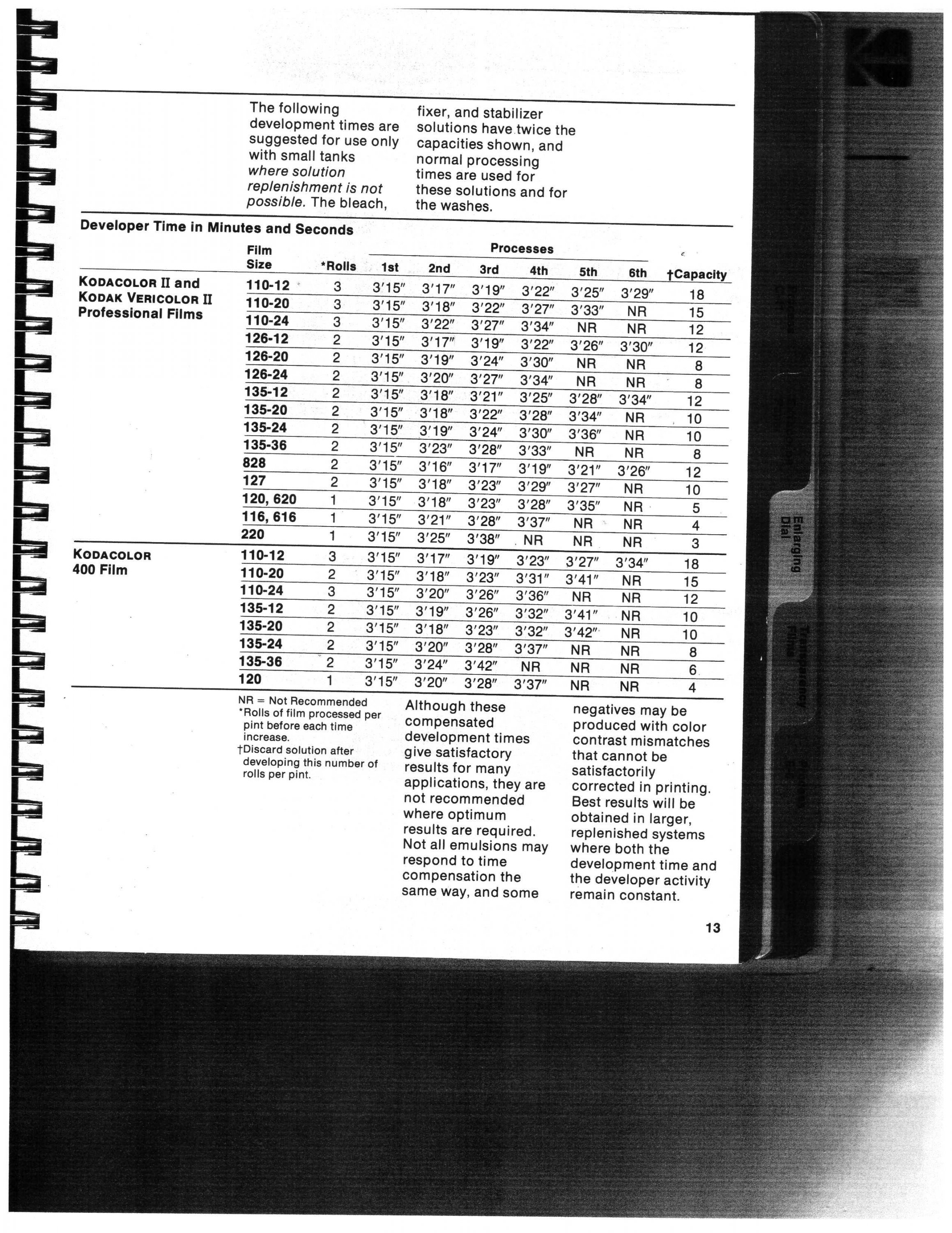

It was good that you found it, because it made me think - check my 1982 Kodak Colour Darkroom Dataguide.
Here are pages 12 and 13, both as jpegs and pdfs:

The reference in that scan to one pint, along with Kodacolour II, may give you some sense how old that document is.
Hey--that's awesome! Also, very helpful!!! I think I was taking photos on a Kodak Discman back then.
Now the big question: I see on p13 of your dataguide that the two film types listed back then have a different max capacity. Where would you put modern films? Using 135-36 as an example (per pint in the chart), the max is 10, and 8. Would modern films be able to exceed that by, say, one "process" to 12? I'm speaking theoretically as a starting point for tests, not definitively.
I have no idea - I've never done this myself.
I think I would ask people who are currently processing old film whether they notice their chemicals exhausting more (or less) when used with old film than with current film.

Well, I'm glad that turned up. I believe I'd read Publication z131, which (when I dig it up and look again) in fact doesn't give any information about time compensation, but the Data Guide confirms 8 rolls of 135-36, with time compensation actually less than 15 seconds per roll (thinking about it, that may have been the Cinestill kit that had that figure).
