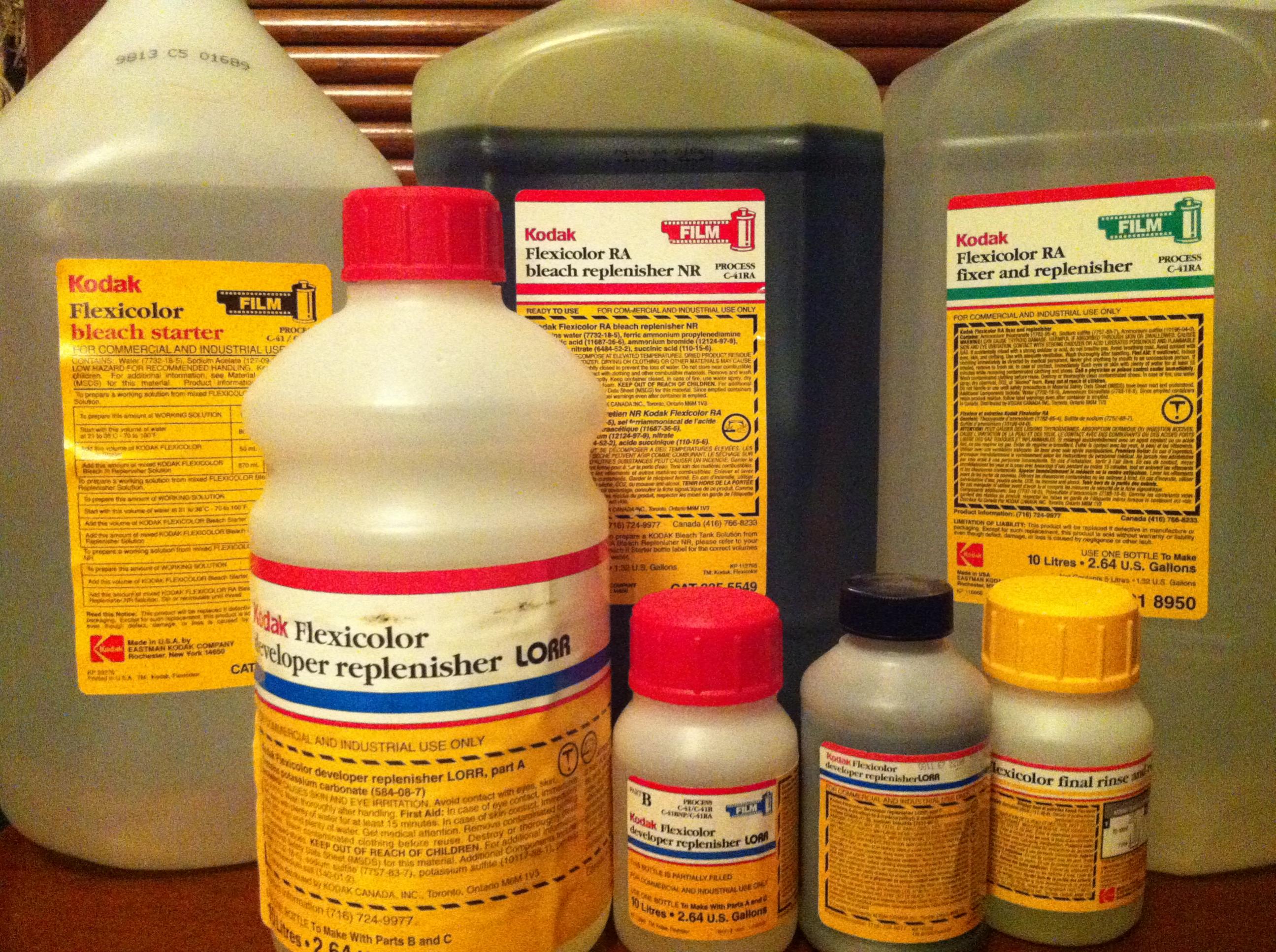

Because I mentioned this thread on another thread about C-41 developing, I thought I'd post a photo of what the ancient Flexicolor bottles look like.
EdSawyer
Sep 3, 2008
1,793
Current stuff looks almost identical to those bottles. ;-)
