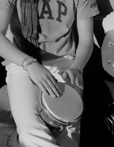

Easy peasy Ilford XP2 rated at 250 or 320, have it processed normally at 400. I know you will love the results and it's perfect for scanning.
Btw. Prints from C41 B&W film are sepia on colour paper.
Edit: Added the only scan I can find of XP2 at the moment :wink:
