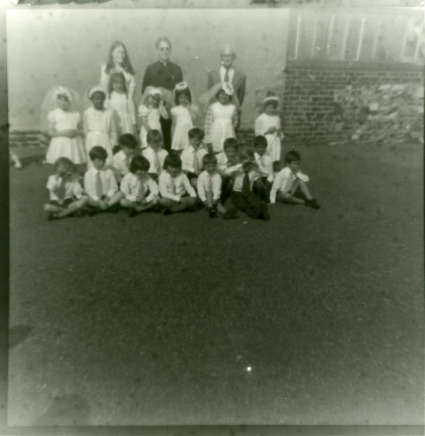

I've developed a roll in B&W chemicals and got fairly good images off of it. Someone suggested speedibrew's celer-41 kit which can be used at room temperture but I haven't seen speedibrew's stuff being sold in the usual outlets so much so maybe they've stop producing their kits while I wasn't looking.
A few of the pictures I've printed from the rather dark unbleached colour negatives. The two of the same picture is just me fooling around with filters on the enlarger head to try to get the best possible image out of it. This was Mark VI film if I remember correctly and I surprisingly didn't have hassle getting it off the backing paper and onto the spool like I had feared. Not sure how much luck you'll have with 35mm as 35mm isn't quite as protected from aging as 120 is.

Well, you never what interesting subject might be on there, Akki14 and myself received the C-22 roll with a 50p eBay camera purchase, we developed it in Diafine to see if anything would come out which basically cost us nothing and got some interesting if degraded images.
We've left the roll uncut because we're still considering if we can process it any further.

Yes but we're a little worried about losing what images we have as we seem to have quite good ones.
The very odd thing about the images I posted from that film is that the film format doesn't match up with the camera. Camera we bought shoots 6x6 the roll of film is 4x4 which is actually to our advantage quite a bit because it means the very worse fogging on the edges isn't really hitting the images themselves. Still seems like the photographer didn't know about, or overcompensated for, parallax error. We estimate that the roll we developed (4minutes in solution A of diafine and 4 minutes in solution b) was taken in the late 70s. We have developed another roll of c-22 a little older than that. We got images of a sort out of it that appear to be 6x9cm format but they look very wonky. As far as I can tell, it looks like the camera was taking a jaunty angle photo of a lightbulb and the exposure wasn't right at all anyway. So yes, the images might not be worth $30/15GBP to get processed properly and wait 6-12months to get back, but if you have normal B&W chemicals, you can develop it very easily and get images off of it.
The only upsetting thing I've found is that I'm unable to locate the original owner of this film that has images of what looks like a first communion on it; the online auction guy we bought it from bought it at another auction years ago apparently. Oh and the comment on this thread saying throw it out! If anyone here is going to do that, they can post it to me to have processed as B&W as I find these things interesting.
