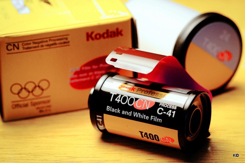

In 2014 they gave me two of this film.
attachment.php
I think, it is same as yours. It has Olympics logo from games somewhere in USA. No idea how it was stored.
I developed it in C-41 kit and it came with huge grain shaped like the frost flakes, but still usable.
attachment.php
I always thought that as a C41 B&W there was little or no grain as the silver goes and only dyes are left. It is not as if it was very old. How did this huge grain like frosted flakes show itself?
Thanks
pentaxuser
It shows itself as frosted flakes on scans, I did not printed from it.
