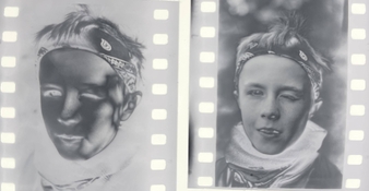

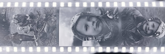

Im not sure how helpful these mobile scans are but they should help some. The first one is of a piano, and the beginning and the ende of the film. The next are to frames next to each other on the roll, one negative and the other 'positive'. I think its strange that two so close frames are so different. The last one is kind of a positives I guess.
I cant understand that this is the bleach as Ive been using the same stuff mixed up the same way for ages. Any clues?

Looks like the Sabbatier effect I was getting on a C-41 reversal process of Aerocolor I recently tried... I notice your underexposed image of the kid is negative while your picture of him with more exposure is positive - that is the threshold effect I was seeing as well, although I saw it in reverse, with the brightest parts of my image turning negative. However I don't know why it's happening here.
