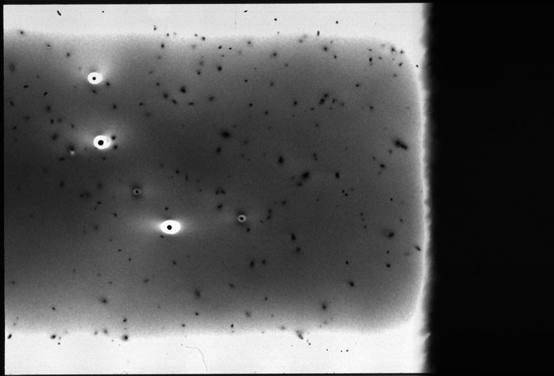

Yesterday I made an attempt at bw reversal and as the title says, the bleaching stage failed. I used 500ml of permanganate bleach, which was mixed just before the bleaching stage. 0,5g of potassium permanganate was dissolved (or so I thought) in ~200ml deionised water and 22g of sodium bisulfate in ~300ml. These solutions were combined just before bleaching, as I mentioned earlier. Previously I had tried a 250ml batch of such a bleach with a piece of already processed, bullet proof leader and it worked nicely. This bleach is similar to the one proposed by Ilford, but with half the concentration of permanganate and bisulfate instead of sulfuric acid. All processing steps were done at 20°C and I bleached for 5'. I didn't invert the tank during bleaching, but used a swirling motion for the whole 5'. This is what the film leader looks like at the fully exposed - fully unexposed section:
index.php
This clearly shows that bleaching was incomplete and the spots were probably caused by undissolved potassium permanganate. So, the two questions are:
1) How do you guys make sure the permanganate has fully dissolved? The solution is too dark to spot any chunks and I'm not sure that filtering permanganate solutions is a very good idea.
2) For how long do you bleach? In this occasion the bleach might have been too weak given the undissolved permanganate and I can probably have a look at the film during bleaching, but your experience would be welcome.

It's not necessarily Undissolved permanganate. (it could be manganese dioxide)
Did you use an acidic clearing Bath (usually sodium metabisulfite) after bleaching?
It may be that your bleach is not sufficiently acidic, but I have no experience with using bisulfate rather than sulfuric acid.
I'm sure Rudeofus or Gerald Koch will drop by and set you right soon.
Oh, yes I did. 12,5g metabisulfite in 500ml water, 2' continuous agitation and it worked well. These spots are more evident in the beginning of the film, which is nearer the center of the reel. There are very few if any at all at the end of the film. The swirling motion I used gathered any undissolved solids towards the center of the reel, just like a vortex would do.

You can dissolve the permanganate the previous day or prepare it as a stock solution. I use a 2% stock solution. As long as there is no sulfuric acid (or bisulfate) it is stable over weeks.
But I also wonder it the problem is undissolved permanganate.
You can inspect the film during bleaching and clearing, with not too bright light.
Thanks in advance!
1.) I always prepare everything well mixed & with warm water in advance, never a problem. Were the chemicals in a good condition?
2.) 3 minutes (agitated constantly and with determination) - but I'm afraid my numbers won't help you
dicromate and sulfuric acid! permanganate is always a mess
The bisulfate is slightly off white granules and gives crystal clear solutions. The permanganate is probably old and was given to me by a chemist friend. He used to work at a lab where they refreshed some of their chemicals and dumped old stock. It is analytical reagent grade, Mallinckrodt branded.
It seems that it's not that uncommon to have some undissolved permanganate. Jens Osbahr in his reversal process document (page 19) states "Pour out the bleach into the bottle very slowly to achieve that crystals which are still not dissolved remain in the Erlenmeyer flask."

I've got both, but it shouldn't matter anyway. I used bisulfate because the sulfuric acid I have seems to have some kind of contamination floating at the top.

I have had very similar looking stains when I processed B&W reversal for the first time, and I am quite confident that undissolved Potassium Permanganate is the culprit. There are two ways IMHO to avoid this:
  1. Follow chrisaisenbrey's advice and dissolve the Potassium Permanganate well in advance to make sure it is fully dissolved by the time you use it
  2. or, for the impatient like me: mix fresh, but filter the Potassium Permanganate solution before use. A simple coffee paper filter will do.
Since I filtered my Potassium Permanganate, I have not had these stains, and my stash of Potassium Permanganate is several years old and looks odd - but still works!

Agitation is essential, but won't solve Anon Ymous's spot issue. I have a strip of B&W reversed film just like that, and agitation certainly was not the issue. These spots never showed up again since I started filtering my bleach.
I think Alessandro means that the horizontal dense part that didn't clear during bleaching wouldn't be there if I used more vigorous agitation.

AFAIK the bleaching process runs to completion, if bleaching appears incomplete, you should at least double bleach time.
