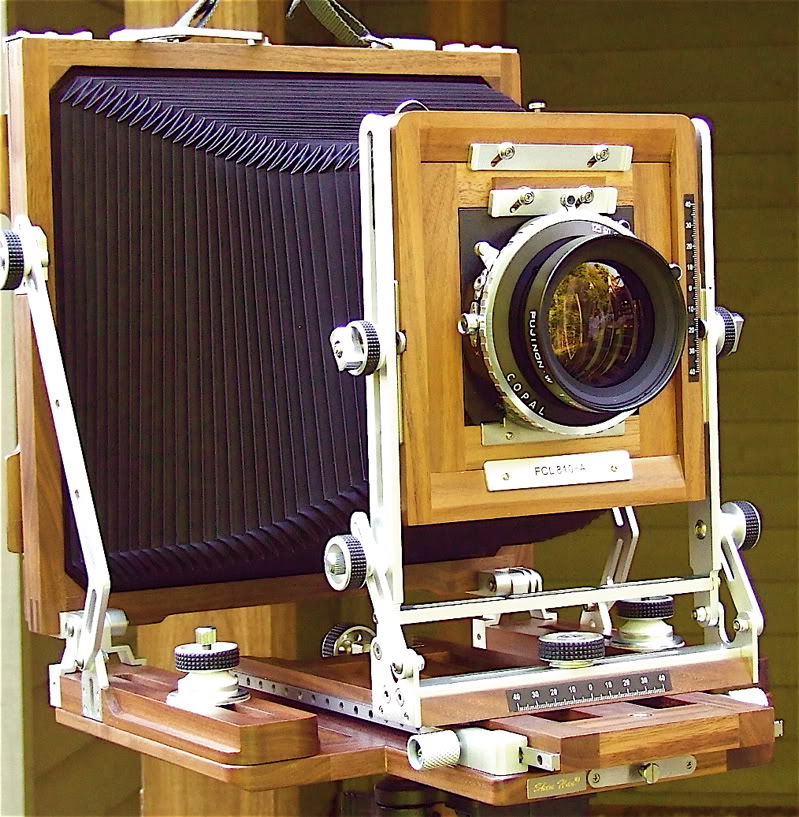

You might be interested in the Shen-Hao also. Price is comparable with the Chamonix and the Shen-Hao has both base and axis tilt on the front standard. Folds without removing the front standard.
