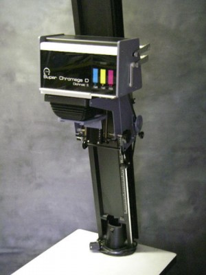

Since I'm the middleman in the first enlarger option (the world is a small place) I might chime in and get some help in trying to identify it! :smile: I have no good images of it so the images below are all hotlinked.
I'm pretty sure this is the same configuration as the enlarger for sale:
No lens cones but a bellow. It comes with the Stabilotime which is gigantic (and heavy):
attachment.php
I've used the enlarger for sale but bought a very similar enlarger (but with a DV head & Ilford below-the-lens filters) which I use in my kitchen darkroom.
With all that said the Durst L1200/CLS450 is a fantastic machine - the enlarger for sale used to share table with one of these! If it works with 4x5" it is much nicer to work with, no refocusing after changing enlargement degree, easy to switch lenses (make sure you get all the parts necessary) and fine tune everything.

Even the type of Omega color head pictured in post #13 can have issues with the filters. And there are 2 mixing boxes; one for up to MF and one for 4x5. No lens cones needed with that model. Neg carriers for the Omega, even if mailed from US, aren't expensive. But I'd go with the Durst in your situation.
