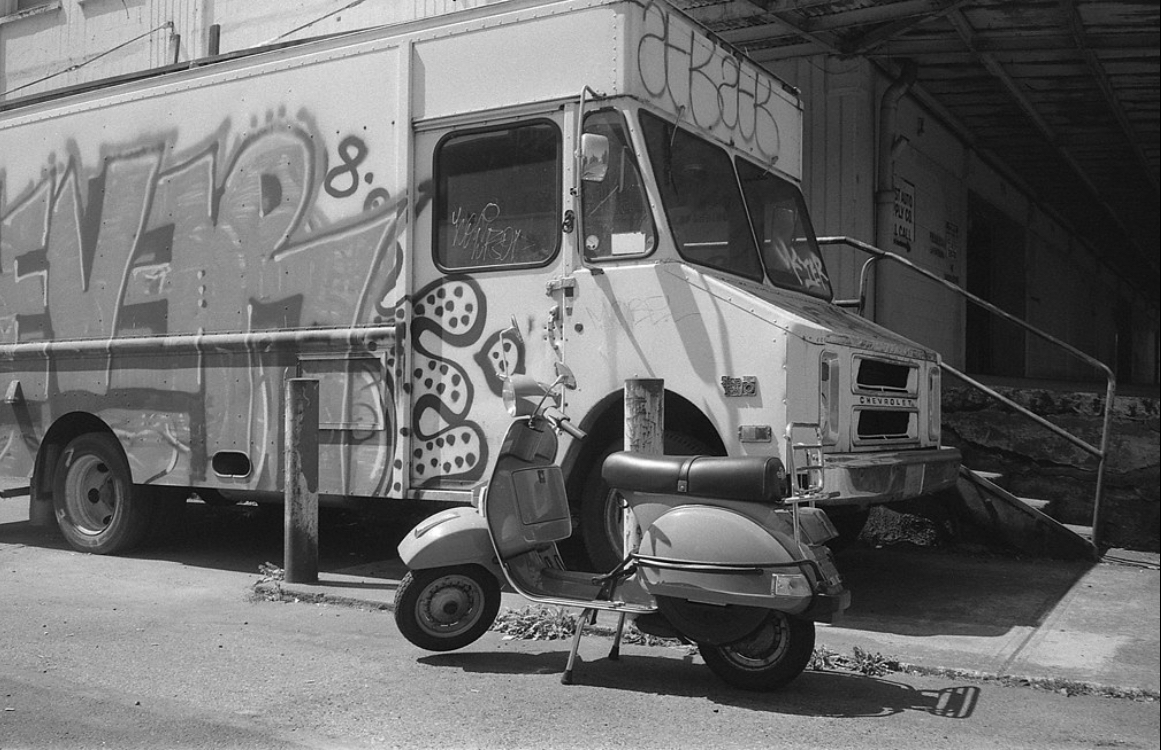

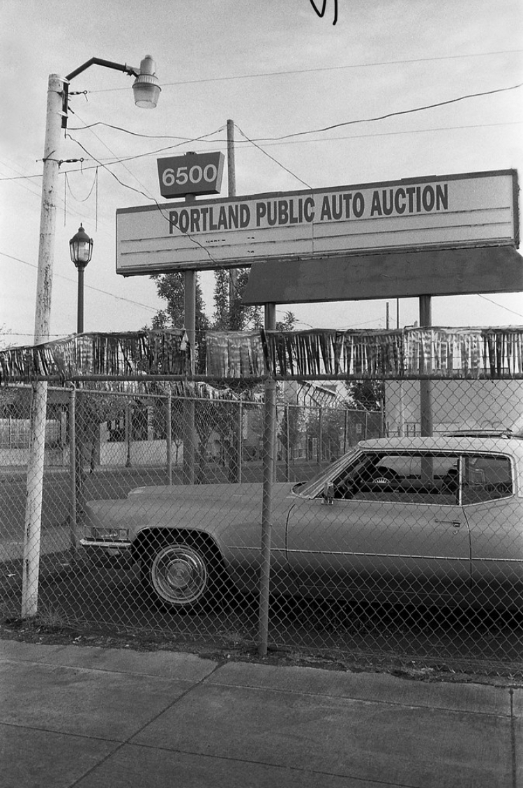

It’s a compensating developer so flat scenes look very, very flat. It’s an acutance developer so grain is sharp. In 4x5 that should be fine. I used it on several rolls of Delta 100 35mm and was not impressed. Other people seem to love it so YMMV. I vastly prefer XTOL. Especially for Delta 100. Here are some of the better examples I had. Delta 100 in FX-39. Leica M2 with Voigtlander Color-Skopar 2.5/35mm.

Although your two images look like scans (a digital photograph of a negative, resulting in new digital tone) and then it's hard to be sure about your negatives, both look slightly underexposed... Or who knows if just scanned for the highlights...
