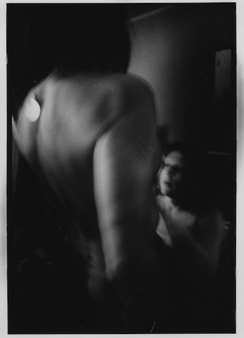

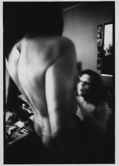

Hi Apug,
for some time now I have tried to hide distracting elements in my prints by burning them to pure black... Without much success.
I have seen it done by other people so I'm sure it can be done, but I am running out of ideas.
I'm attaching two prints to give an example of what I'm trying to do.
The first (lighter) print without burning and the second one where I burned the top right and bottom left for approximately 7+ stops with filter 00, by holding a card with a hole in it above the print. In fact there is so much added light that the white borders of the print have fogged slightly.
It's showing less in the scans for some reasons but the burned parts are still showing faint traces of highlights, and the mirror behind the girl on the right is clearly visible.
I'm also well aware that the whole print is much darker compared to the first one, I probably have some light bouncing between the burning card and the rest of the printing station, but I'm not trying to solve that problem for now.
So if anyone knows how I could achieve what I'm trying to do, I would be most grateful. I'm especially looking to improve my printing skills without delving in complicated masking and/or resorting to bleaching the neg.
Thanks in advance.

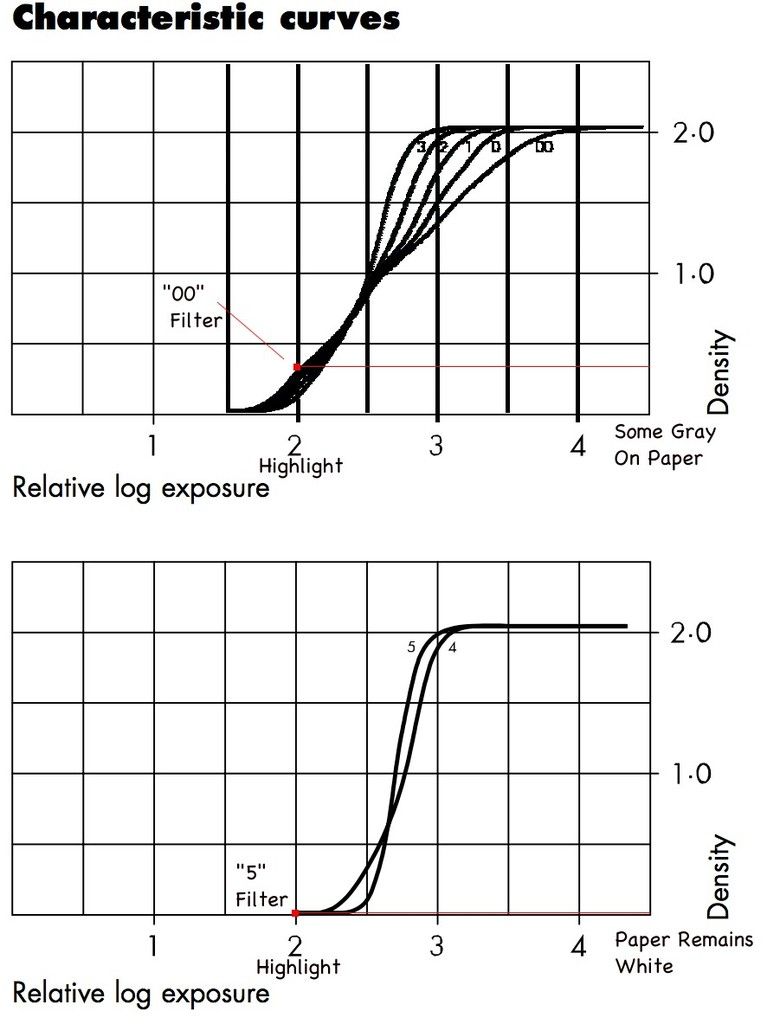

You are on the right track with the 00 filter as the high contrast filter won't touch the highlights. In this extreme case I'd use a pen light to burn/flash selected portions of the image and red filter under the enlarger lens to see the image.

You're correct that using a lower grade like 00 will affect the lighter tones more easily. A higher grade like 4 or 5 will get you deeper blacks, but will have little effect on the highlights. To burn those bright areas down, I would try using something like a penlight to selectively burn the paper in those areas. You can easily cut out a mask of cardboard or thick paper so the penlight doesn't expose any other parts of the paper. It will take some experimentation to get the best, and to keep it from looking too "manipulated".

Adding a #5 filter exposure or using less than 00 to burn a highlight does not help or maybe even do anything.

Is it not best to start with a very soft to get the highlight greying up and then increase the filtration once the highlight is in a tone that will be affected by a higher grade filter to get the deep black?
The OP has told us that he has tried to burn-in with a 00 filter for 7+ (SEVEN) additional stops and could only achieve grey. Seven additional stops with a not too small print would usually mean several minutes of exposure. This particular negative has the area of the mirror so dense that an extremely long exposure time would be required with any filter (don´t forget: a Filter 5 requires double exposure time). Just have a look at the charts posted by ic-racer Therefore the suggestion to remove the negative when burning in that particular area or to use a flashlight or hot water / developer.
Starting with a 00 filter and changing then to a 5 filter (Splitgrade for burning in?)? I have never tried but would guess the particular effect depends on the paper and the negative. With the negative the OP is using, I would not expect too much - it simply is too dense.
