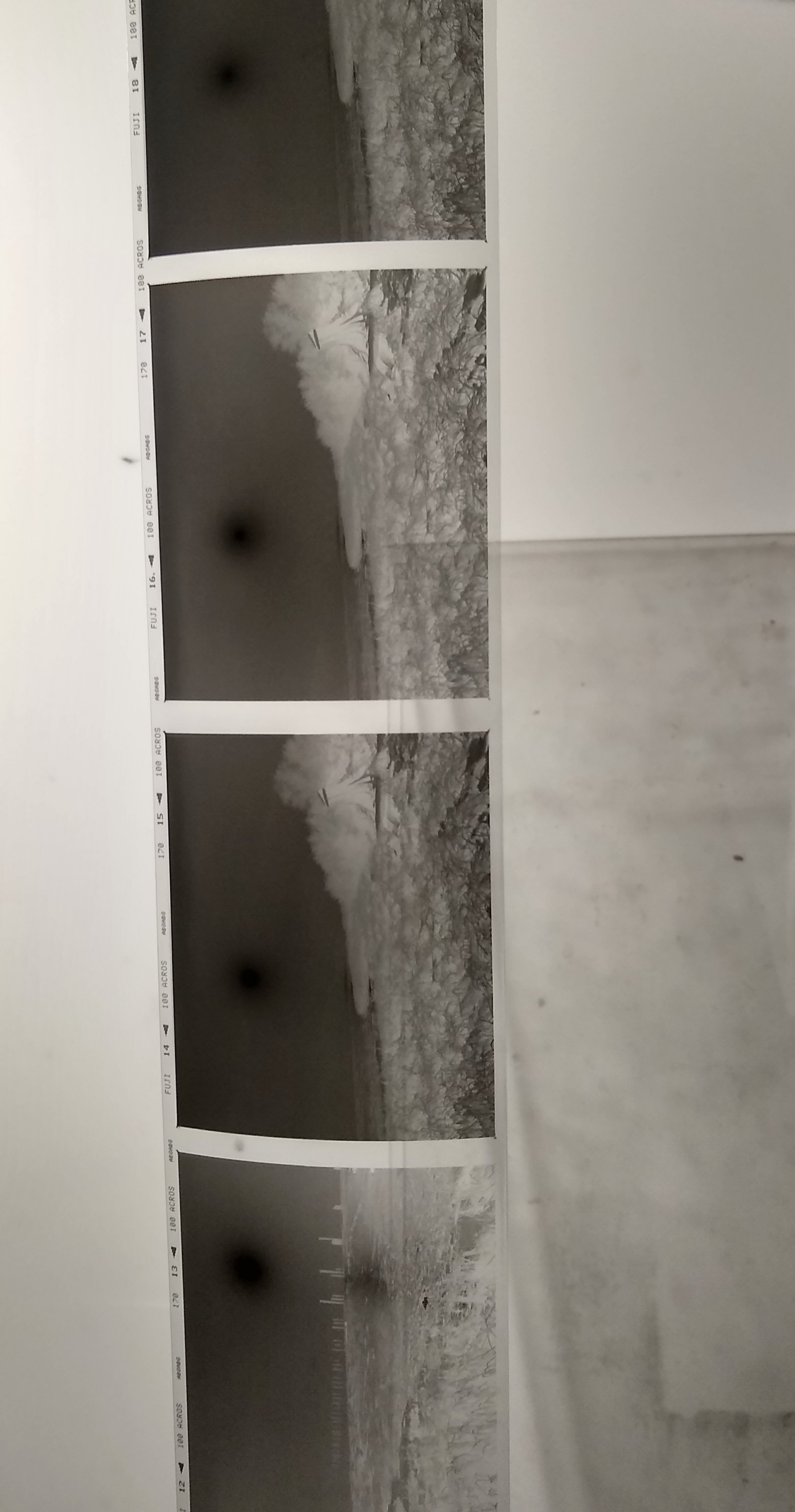

Spent the morning wandering around the Pitt River...more like trudging through the mud to get to a stump at river's edge that I've photographed a few times over the years. Had with me the RB and a couple rolls of Acros I. Shot only one roll. Went home and commenced processing it. Was going to develop it in Pyrocat-HD, as I usual do, but the 100ml I had remaining of solution A had finally gone bad (mixed it up back June)... If I didn't process the film now, I know I wouldn't be able to until well after Christmas... so.... Ilfosol will have to do. Now for some strange reason, I set my clock for the Pyrocat-HD time of 16 min. (EI 64). I should have set it for 8 (1+14)! I didn't realise my error until it was in the fix! I pulled the roll off of the reel and sure enough, bullet proof negatives! I have never made this mistake in the 30 years that I've been doing this, so I felt really bummed out. The only other time I ended up with bullet proof negative was when I was out with the 8x10 in deep powdery snow, and forgot my light metre. My guess at exposure was way off! But... I was able to still print it. Once these Acros negs have dried, I'll proof them tonight. We'll see...

Whenever someone refers to a negative as bullet proof, it means cannot see through it... at least in my experience. Either from gross over exposure, over development, or both. In my case, from over development.
I proofed them, and they look like crap. So... I'll head out there tomorrow morning and do it right.

Sadly they are meant to be scanned. The high lights have brutal artifacts. I'll contact print them in the darkroom and see if I can scan those. But first, I'll try a reshoot later this morning.

Yesterday's reshoot went even better. Nice foggy light to work with, Acros
and D-23.
