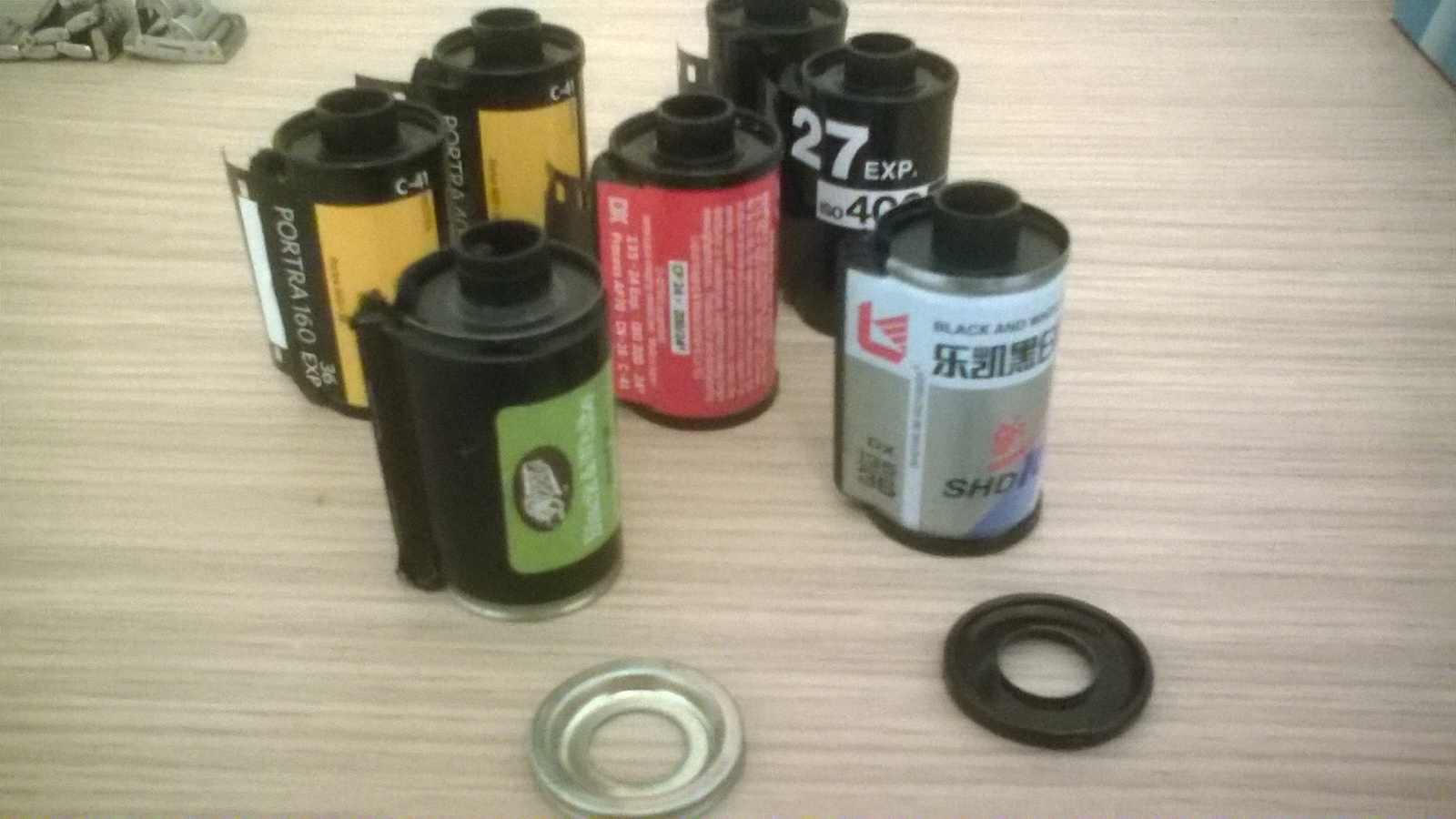

See some of my cassettes. The first 2 are reusable. The others come from a lab:
