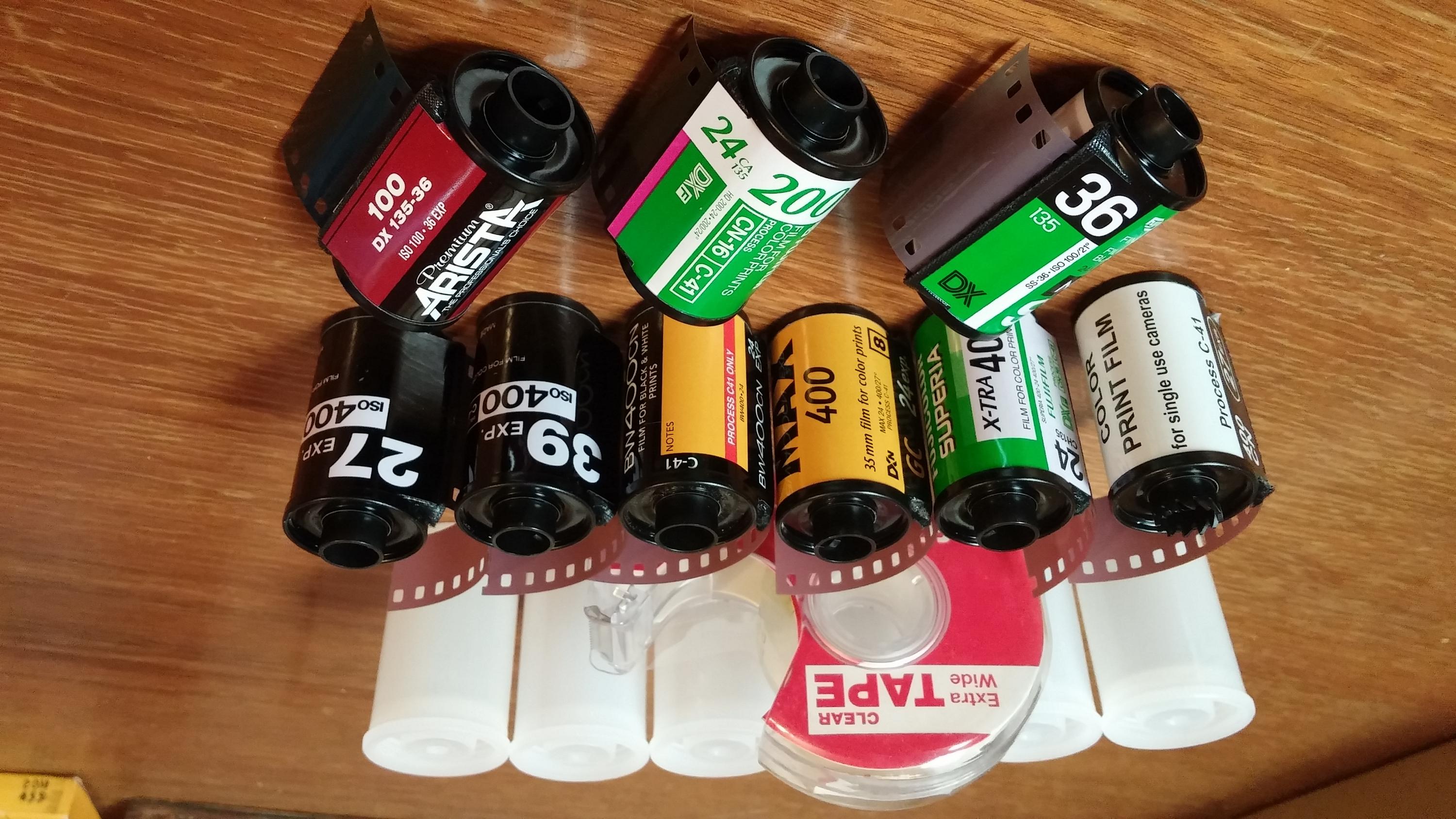

I am using old film cassettes for bulk loading and seems to work ok. I had collected a bag full of old film cassettes from some mini labs and decided to reuse them. I saw this somewhere that you could reuse old cassettes by taping your bulk film to the end of the film left on the old cassettes. This seems to work fine if you but the film ends together and tape them. This might help also if you need to use bulk film in a non DX camera. I found several 100 and 400 ISO cassettes that would work fine for this. I include a picture and the rolls in the background are TMAX 400 36 Exp. Hope this helps anyone trying to save by bulk loading.
Dear Marvin,
It is MUCH better to use re-loadable cassettes designed for the purpose.
You can do it your way but a few 'be very aware's' though.
1 ) Attaching film to film can build stress and deform inside the cassette so if you must do it do not 'overload' 24's good 36's bad.
2 ) You have a higher risk of the film becoming detached inside the camera, camera wind on mechanisms are very strong, if this happens you should realize it and can retrieve the film in the darkroom.
3 ) You have very little film to presume the film is attached parallel, if its not you can stress the film and the camera mechanisms.
4 ) AND THE MOST IMPORTANT : Like most manufacturers we load 'through the cassette velvet mouth' part of this process involves moving all the velvet to face inward using a tongue during manufacture, the film leader is then 'pulled' back automatically to 'reverse' the velvet. Single use cassettes are just that, you cannot repeat that process, the cassettes themselves are much 'tighter' than re-loadables... so repeated insertion risks scratches at a much higher level than using re-loadables, damaged velvet that can allow light leaks or velvet fibres becoming dislodged.
Simon ILFORD Photo / HARMAN technology Limited :
Shutters can get indigestion on velvet thread or film shards...

I understand the desire to save a few bucks, but as soon as you've have a roll or two of film utterly ruined by reusing factory cassettes, you've wasted far more money than the cost of reusable cassettes ever would have been.

Maybe my memory is faulty but in the several threads I have seen on bulk loading this is the first one where the consensus seem to be that re-using a factory cassette and attaching the bulk film to the piece that is left after the mini-lab had developed the original film is likely to lead to problems.
Yes, it is true that the machinery in a mini-lab that cuts the film leaves only about half to three quarters of an inch to which to attach the bulk film but if you have a steady hand this is enough to attach it securely and squarely with decent masking tape. It is the way that Kodak until recently and maybe still attaches film to its factory cassettes
The great thing about factory cassettes is that they are designed to run smoothly and are well enough made to run films at least twice. I hope that Simon Galley would not disagree that his cassettes are well made :D
If you have access to a mini-lab's stock it will gladly give you its old cassettes that otherwise it dumps.
Attach the bulk film to these carefully with decent masking tape and only use them once and I see no reason why you should have problems
If you use a fully automatic camera that only recognises codes such then you have little choice unless you buy DX codes.
Even better keep all your old factory cassettes and use these. This way you can leave at least an inch out and as you can be sure it has not been damaged in the camera as it has always been your cassette you might be able to use it twice at least
Yes the velvet lip will wear and may pick up dust and grit( less likely) but a post-it note run across the lips should ensure that it is OK.
Like Mark Twain's death the dangers of re-using factory cassettes for bulk loading is, I fear, greatly exaggerated.

Thanks for the input pentaxuser, and I have a good supply of factory loaded film that I will try to use the cassettes from. There is a Arisa 100 roll in the pic that I processed myself and saved. I used the clear tape in the pic and made it long enough to wrap around to the other side. I am afraid the mini labs have about gone by the way, so don't think I will have a future supply. I stocked up on HP5 when Ilford had a sale 3 for the price of 2 sometime ago. Just trying to make my film resources go as far as they will. I have to go and put this water bottle in the recycle bin.:D

I have reloaded factory cassettes. However it does make a difference what adhesive tape you use. Some like masking tape have too little stickiness. It is also a good idea to put tape on both sides of the film. If the film should come loose in the camera then you have a problem.
I just used the tape in the pic, and it was just store brand scotch tape. It had a good stick to it and I raped it around the film for a good hold. Beware that some masking tapes use for painting have low stickiness for easy removal. So far good results, but thinking about ordering a 25 pack of those metal cassettes.
