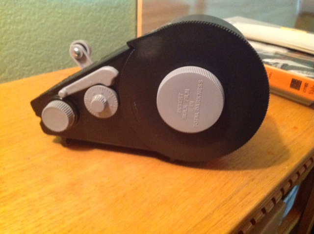

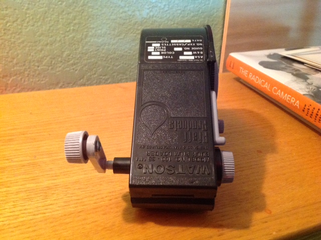

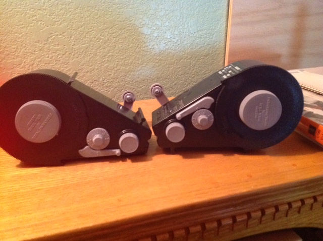

I bought an enlarger a few years ago. The gal included just about everything Thing/Accessory she had. So inherited these two Watson Loaders.
My two questions.....
1. Do you guys still bilk load.? Seems like Ilford HP5 is a decent savings.?
2. Are these Watson a decent unit for a beginner to learn with...is there something "better".?
I watched a few Youtube videos about bulk loading when i got this stuff, but i never used them. I will definitely take another look and see what is available for Bulk Loading Tutorials.

2. Yes
Is there anything better? The Lloyds type offers a shorter "in light" film path, and therefore wastes slightly less film in the leader and the trailer than the Watson types, but depends on a felt light trap that can require care.
I have both types, and use both.
There are some tips that are handy to know when you bulk load.
The biggest advantages (in my mind) of bulk loading are that it permits me to load rolls that are the length I prefer, at the time I need them.
I also appreciate how little space it takes to store one hundred feet of film, both in a loader, and in a storage space before it goes into the loader.

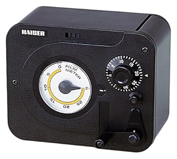

Yes to one and yes to two. Are there better, I think so.
As Matt suggests there are bulk loaders that don't use a felt light trap, that, over time, may pick up dust and other particles that may scratch film.
I myself have 4 bulk loaders, all are either the Kaiser from Germany or in the case of of one of mine, a Japanese copy of the Kaiser.
The Kaiser unit opens a trap door after you have closed the outer lid over your film cassette. The trap door opens when you insert the winder handle. I have been using mine Kaiser (and others) for close to 40 years now. Before that I used one similar to the Watson unit you have.
They are an excellent way of conducting your hobby and the possibility of loading say 12 frames for a test shoot and development of the film, is certainly one of the features I have exercised over the past 5 decades.

The Watson's pretty good. You have to remember to open the light trap before you start to crank the film into the cassette; if you forget to do that, the film will load but it will get scratched. Mine also has a dicky frame counter that often skips frames unless I give it a light push.

I have two Alden 74's, which are almost identical to the Watson, except the locking lever is metal on the Alden. I believe the Aldens are made of Bakelite. I got them both as auctions, and very cheap (~10 bucks each). I've thought about changing to the Kaiser style loaders, but have decided it's not worth stressing over the few frames gained by doing so, and I believe they tend to be pricier even used. Of course, if I ran across a deal I'd buy one.
The cassettes I use are just the cheap plastic ones (I believe they're Kalt brand), they're easy to use and work great, but I'd like to start replacing them with nicer metal ones. I clicked your link, but it looks like you cleaned them out of stock!
