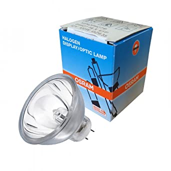

Thank you guys,
Could fit this one? https://www.ebay.co.uk/itm/20-in1-N...410db9394425a3e14829|ampid:PL_CLK|clp:2334524
Can I change directly this?

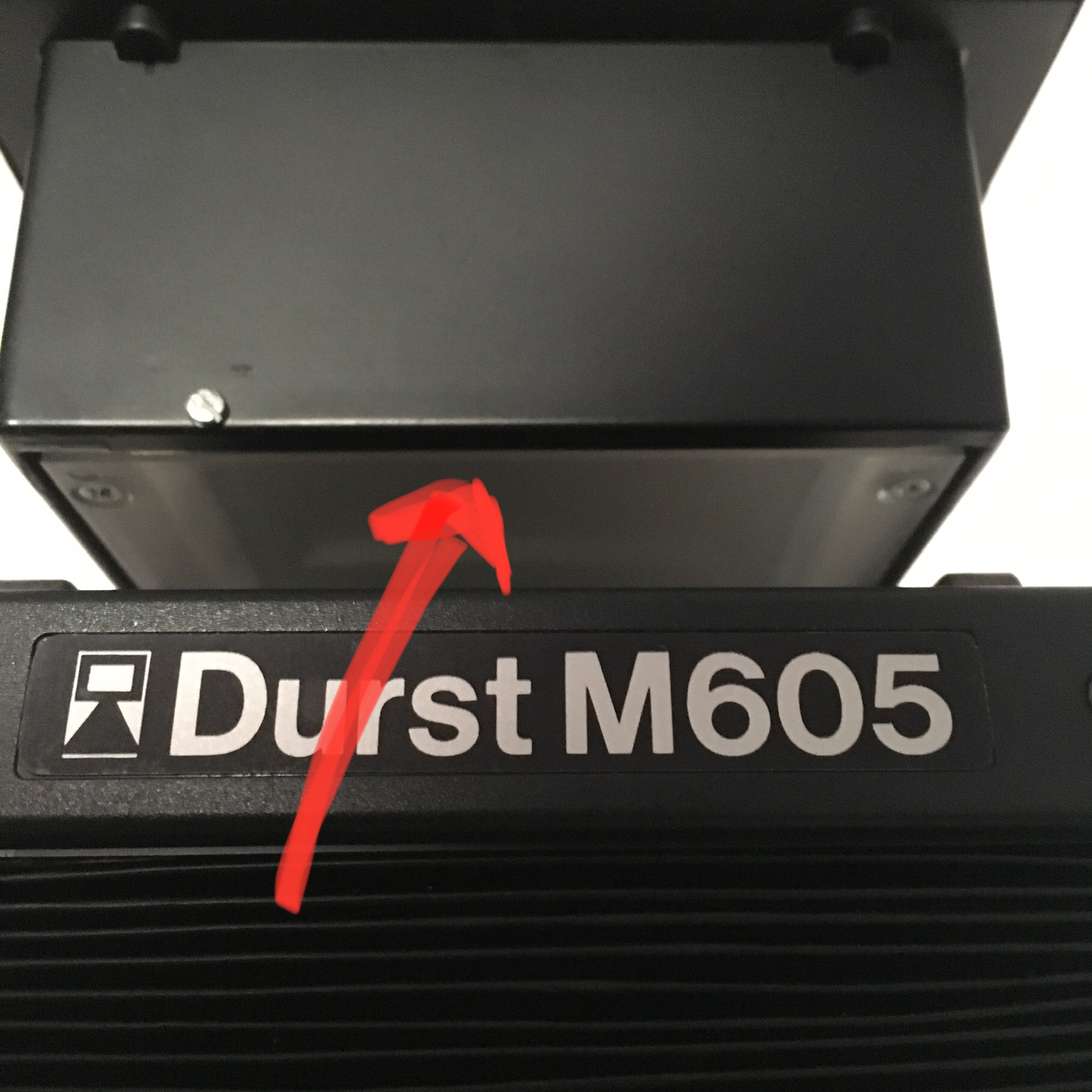

From the part of your enlarger you have shown us it looks like a B&W condenser diffuser so not a colour head one? These don't have halogen bulbs. Does your enlarger have a colour head. It doesn't look like it. What does your bulb look like and how does it fit. Is it like a normal bulb or a flat faced one with two male spikes at its end that fit into a female ceramic holder?
Can you help me to be sure if it is a colour head or a B&W enlarger before I make further comments. All I will say is at this point is that dropping the wattage to 75W from 100W does change the light intensity. That the laws of light so if there is genuinely no change in light intensity when you use a 75W then something else has to be wrong
Thanks
pentaxuser
Head with colors Magenta Yellow Cyano.
Here how it looks:
The lamp used inside is: 12V 100W
