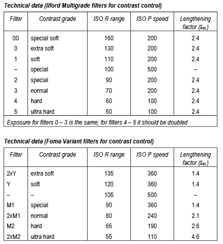

BTW, do you happen to know what ISO Fomaspeed Variant 312 is?
If you're exposing it as if it were camera film, something in the range of 1-2 ISO. The ISO-P paper speed of Fomasped Variant III is specified as follows:
