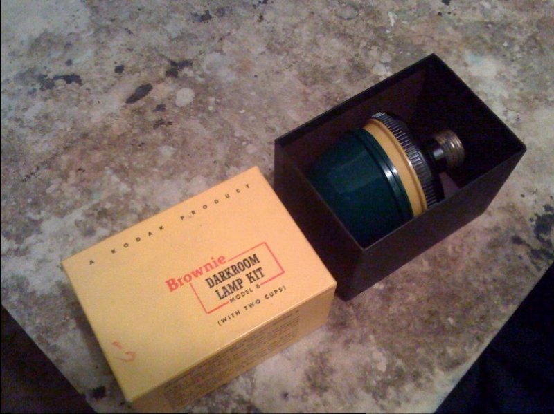

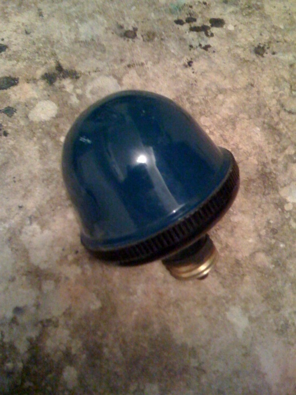

I've been using the same small 7watt Kodak Brownie dome safelight for all the DBI I've done over the last 4yrs or so.
