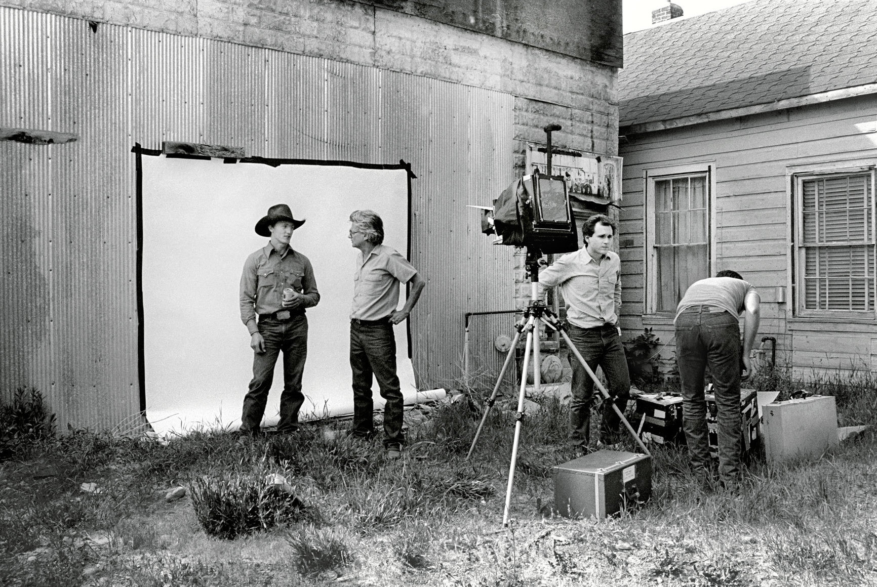

If you look at Laura Wilson's book "Avedon at Work" you can see that he photographed on the shady side of a building. This is essentially what Lindbergh is doing: blocking most overhead and side light and then bouncing light in from the front with a big reflector. Obviously much easier to do Avedon's way.
