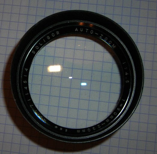

Today, out of curiosity, I took an old zoom lens apart that I had lying around. While doing this I was thinking "what if I would build a camera around one (or more) of these separate elements?". So I have a few questions about how I should approach this.
First of all, how can I determine the focal length of these lenses?

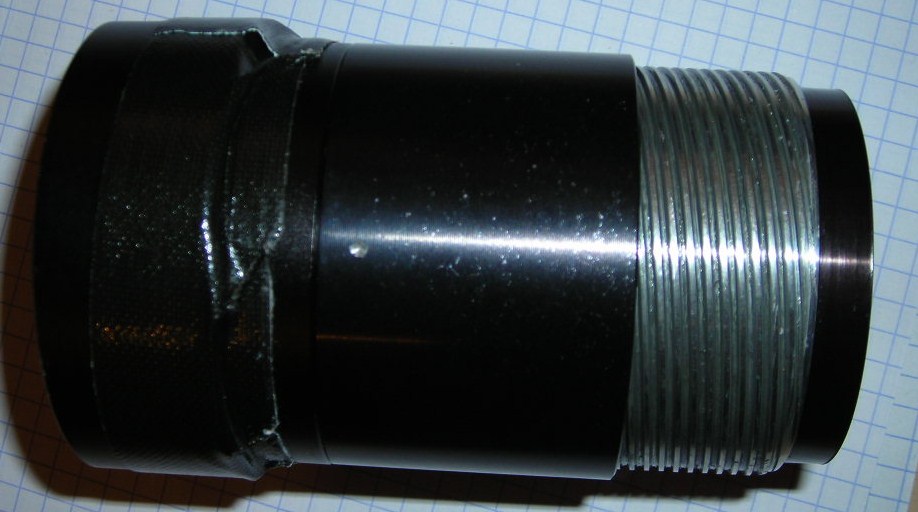

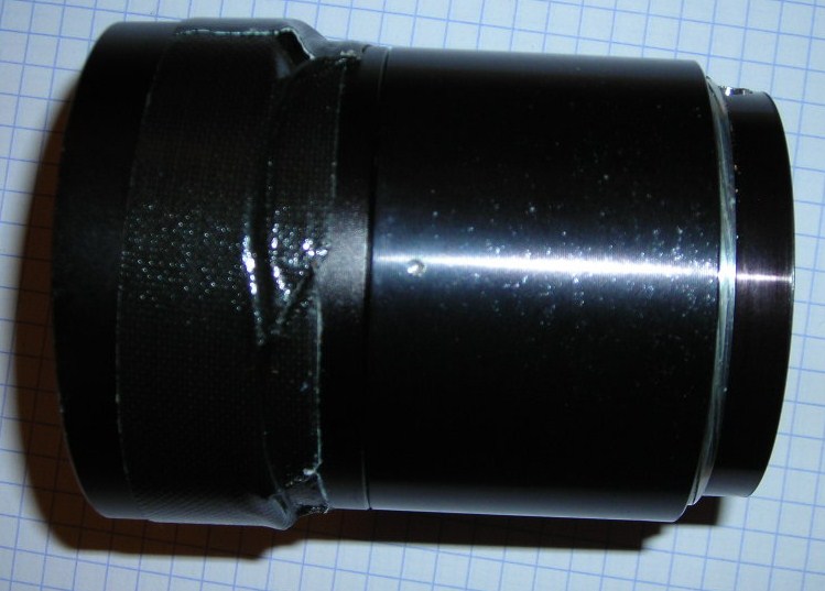

John, I really enjoyed that video! :D So it turns out that the focal length is ~ 115mm and the aperture around F2.1. There are already a few more things that I'm considering to add to the design such as the ability to use waterhouse stops, which should be very easy to make myself. Do they have be inserted at the nodal point, or doesn't that really matter?
There's also a way that I could somehow have a limited focus range. In the pictures you'll see a threaded cylinder which screws into the barrel that holds the lens. Now if I were to attach this piece to the lensboard I would we able to move the lens an inch further away from the film plane, thus allowing me to focus to a closer distance. Could anyone tell me how I can calculate the distance to which I would then focus? That way I can decide if it's worth the trouble or not to use this piece.
