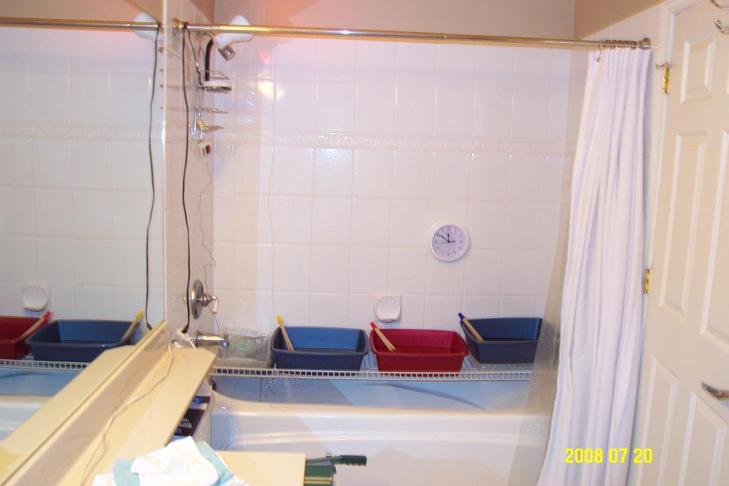

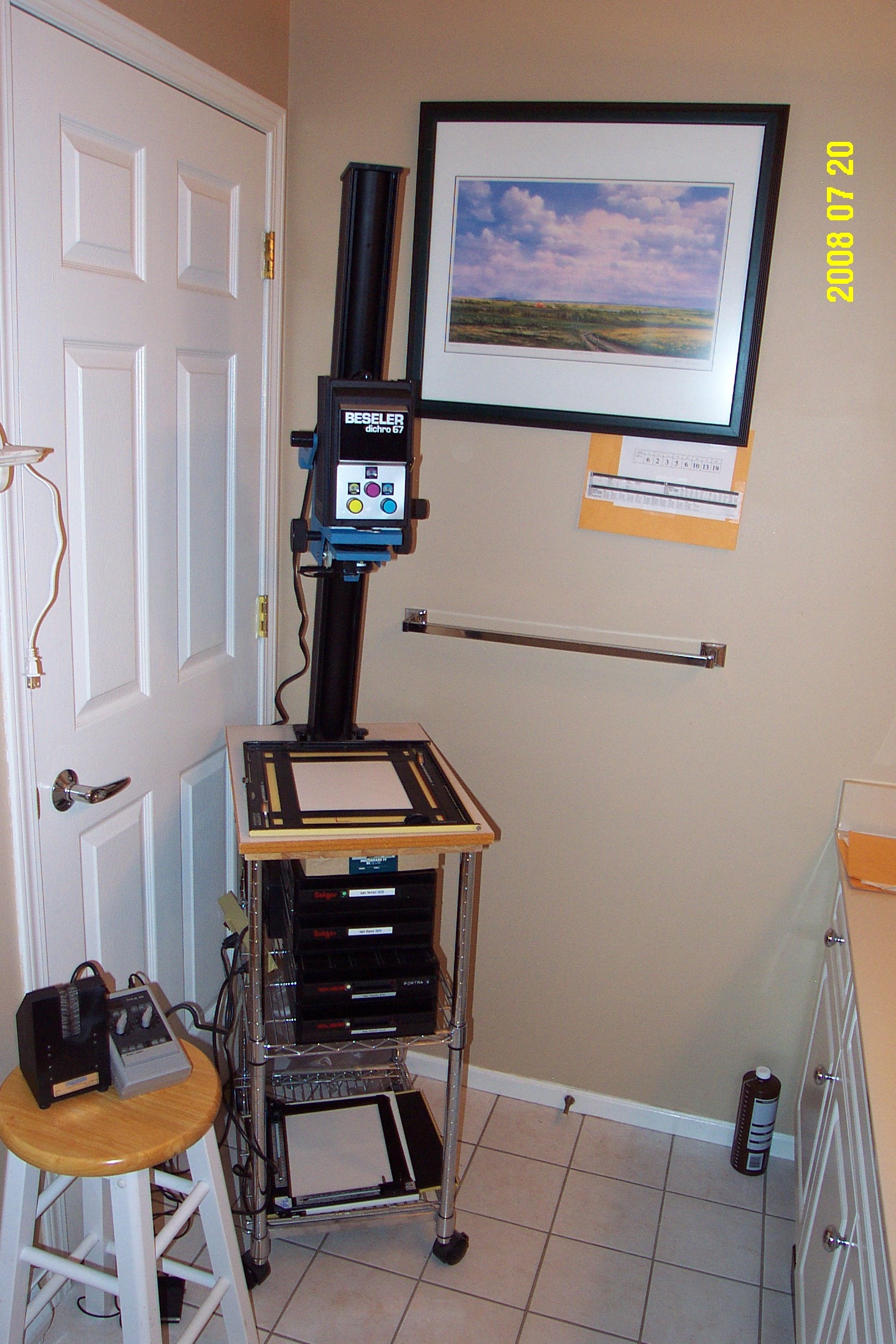

Here are some pics from my darkroom with my smaller enlarger on its cart.

The Beseler Matt shows is a decent and compact enlarger, so is an Omega B-22. Neither is heavy
but putting it on wheels makes it easier to move around.
Matts has a color head and can work with 6X7 negatives, The Omegas are 6X6 and usually found with a B &W head
but there are color heads that will fit.
The Beseler's also available with a B&W head. Prices today don't show much difference between them.
