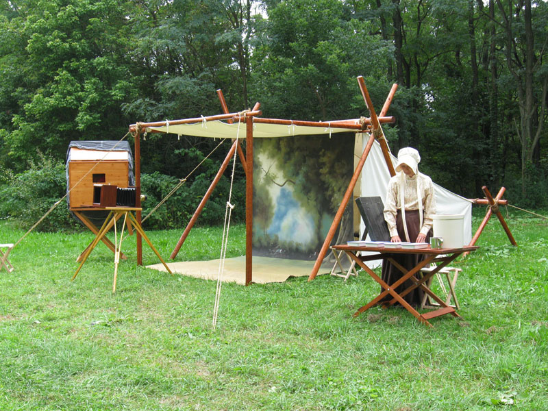

darkbox
Nick, I'm not a reenactor but i did have to build a period correct setup for a few shoots I was doing. Most of the time I work out of a darkroom van that I built but here is a few pics of a period correct setup that I built. If you'll notice the darkbox in the photo is where the plates are sensitized and developed.(there was a url link here which no longer exists)

yup, understood re. the dark time - I've watched a few vids online and its seems ok - most of my time in the darkroom for pt/pd is tray developing the negs...
